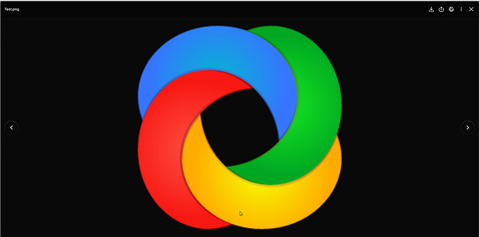

I want to use the link share for shareX (screenshot) and ?wrap=1 is not displaying the image out of bounds. (horizontal scrolling)
preview in backend:
Any other hidden option ?
In worst case I would try to implement my own over 404.html
oh I see, the preview page is coming from the storj UI itself, linksharing does not have an equivalent feature. Unfortunately I think you’ll need to implement your own.
