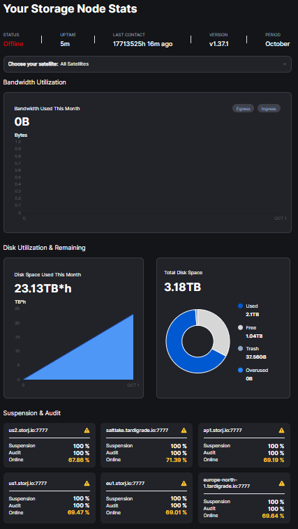

with docker option --network=ā€œhostā€ i can access dashboard.
But this :confused:
ERROR contact:service ping satellite failed {ā€œSatellite IDā€: ā€œ121RTSDpyNZVcEU84Ticf2L1ntiuUimbWgfATz21tuvgk3vzoA6ā€, ā€œattemptsā€: 9, ā€œerrorā€: ā€œping satellite: failed to dial storage node (ID: 12GgvLSny7xMianCWX5WMbq4DqoDrau3ckHiqNf18Xx6hD3jKML) at address 213.175.54.3:6070: rpc: tls peer certificate verification: not signed by any CA in the whitelist: CA certā€, ā€œerrorVerboseā€: ā€œping satellite: failed to dial storage node (ID: 12GgvLSny7xMianCWX5WMbq4DqoDrau3ckHiqNf18Xx6hD3jKML) at address 213.175.54.3:6070: rpc: tls peer certificate verification: not signed by any CA in the whitelist: CA cert\n\tstorj.io/storj/storagenode/contact.(*Service).pingSatelliteOnce:141\n\tstorj.io/storj/storagenode/contact.(*Service).pingSatellite:95\n\tstorj.io/storj/storagenode/contact.(*Chore).updateCycles.func1:87\n\tstorj.io/common/sync2.(*Cycle).Run:92\n\tstorj.io/common/sync2.(*Cycle).Start.func1:71\n\tgolang.org/x/sync/errgroup.(*Group).Go.func1:57ā€}

With my identity a get nubers 1 and 2 :confused: First time i had 3 and 2. Need i new token and new identity?

I cant start container with new identity. This is log after revert to old identity
You should not replace the identity on a working node. The identity is the node. If you replace it - it will be completely different node and it will not recognize a previous data, and finally this data would be slowly removed, and the old identity become disqualified.
The error points to the fact that identity still not signed.

2021-10-02 10_36_32-192.168.1.94 - PuTTY
Now you need to request a new authorization token and sign this identity:
sudo identity --config-dir /mnt/STORJ/identity --identity-dir /mnt/STORJ/identity authorize storagenode kowy54@mail.net:1323kpjoerjerjpoerkrfop3ipoferkp..
I“m online <3 So next time just i need to check confirmation and sign my identity?
There should not be a next time for the same node :slight_smile:
But for the new node - sure.
