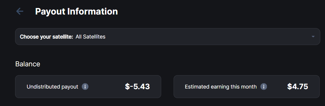

Undistributed payout .. Negative?
I’m seeing negative figures on undistro payout …
why ? whats the repercussion of this ?
$-1.89

It seems I’m in debt—what’s the punishment for?
I feel like there will be thousands of nodes like this ….. I think we didn’t get paid enough from last payout … not they going to take more off us as a “debt” @Alexey @littleskunk - do you have any information?
This is a technical difficulty. We didn’t have time to update SNOs, and it’s hard to support our special Chapter 11 situation.
Our database calculated what was the usage (owed) and what can we pay for the part of July which was before CH11 (0 USD can be paid today, due to the dependency on court) for
We did pre-payment for the active nodes based on estimation. Which means we paid more what we should do based on the ledger. That’s why it’s negative.
Assuming the screenshot is about July, I think 5.43 is the pre-payment, 4.75 is the usage for the short July (pre-CH11).

Opposite. Positive “undistributed” means we didn’t pay what we should. Negative “undistributed” means we paid more than what we should (because we do pre-payment)
I will check how can it be displayed better on web interface.
