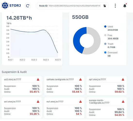

Hello,
It seems my node is normallizing:
But I noticed these notifications:
The only errors in the log are:

What is your opinion?
Looks like your stats are rebuilt, so that’s good news. Your node would have been suspended for being offline (scores below 60%). If you keep your node online, it should recover the online scores and come out of suspension. The online scores will take at least 30 days to get back to 100%, so expect those to rise slowly. I think your node will come out of suspension sooner than that though. While in suspension, your node will not receive any ingress data, only egress (download) requests.
This is a normal error that you will see from time to time. Nothing to worry about
This error is probably related to stats re-building. If it continues to occur, let us know. Shouldn’t be a problem.
This error usually occurs when the node is under heavy load, especially during the initial startup/filewalker process. If it shows up occasionally, it is nothing to worry about.
This is the message related to UDP/QUIC not being set-up. No action required except for setting up UDP/QUIC as described above.
You will also notice a lot of data in the trash for the near future, as many of your nodes pieces will have been repaired to other nodes while yours was offline.
