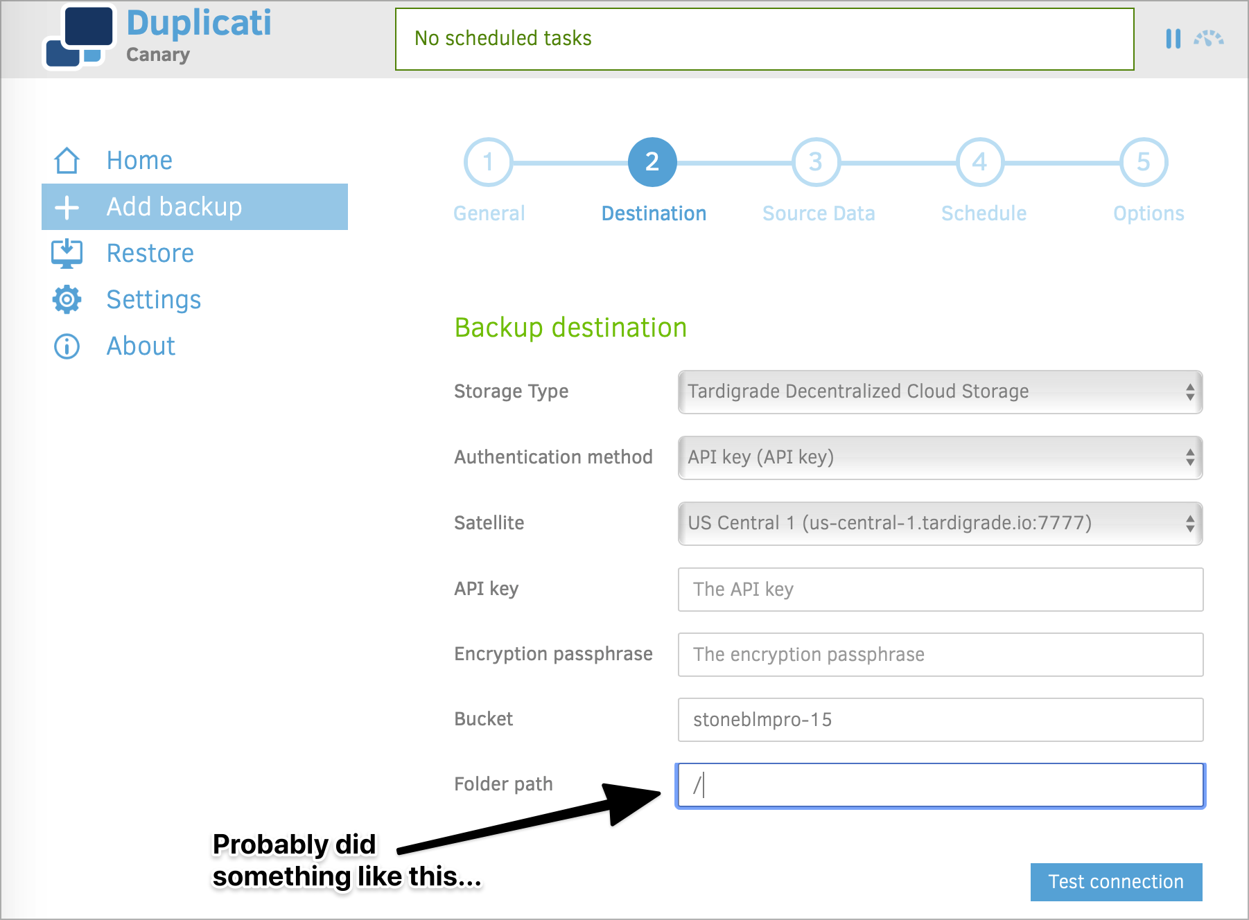

I was setting up duplicati for backups to this bucket. It was successful (based on the list of objects above). I may have done something like use / as the folder path for the backup job:
I’m not positive b/c I have removed that backup job and I was doing some POC type work, and later decided to use /backups as a folder path.

Then please, use a backup path instead of /backup.
Because the /backup has an empty prefix. The first / will be automatically added by library (or S3 Gateway) and your path will be sj://stoneblmbpro-15//backup instead of sj://stoneblmbpro-15/backup thus you will receive the same result with empty prefix.
