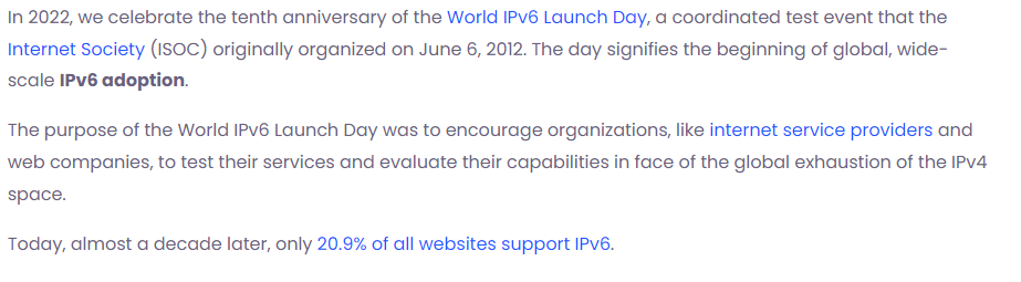

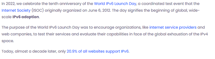

This topic has been discussed several times in the past. The following is some detail as to the issue…
A good read https://www.ipxo.com/blog/ipv6-adoption/
Today, almost a decade later, only 20.9% of all websites support IPv6.
