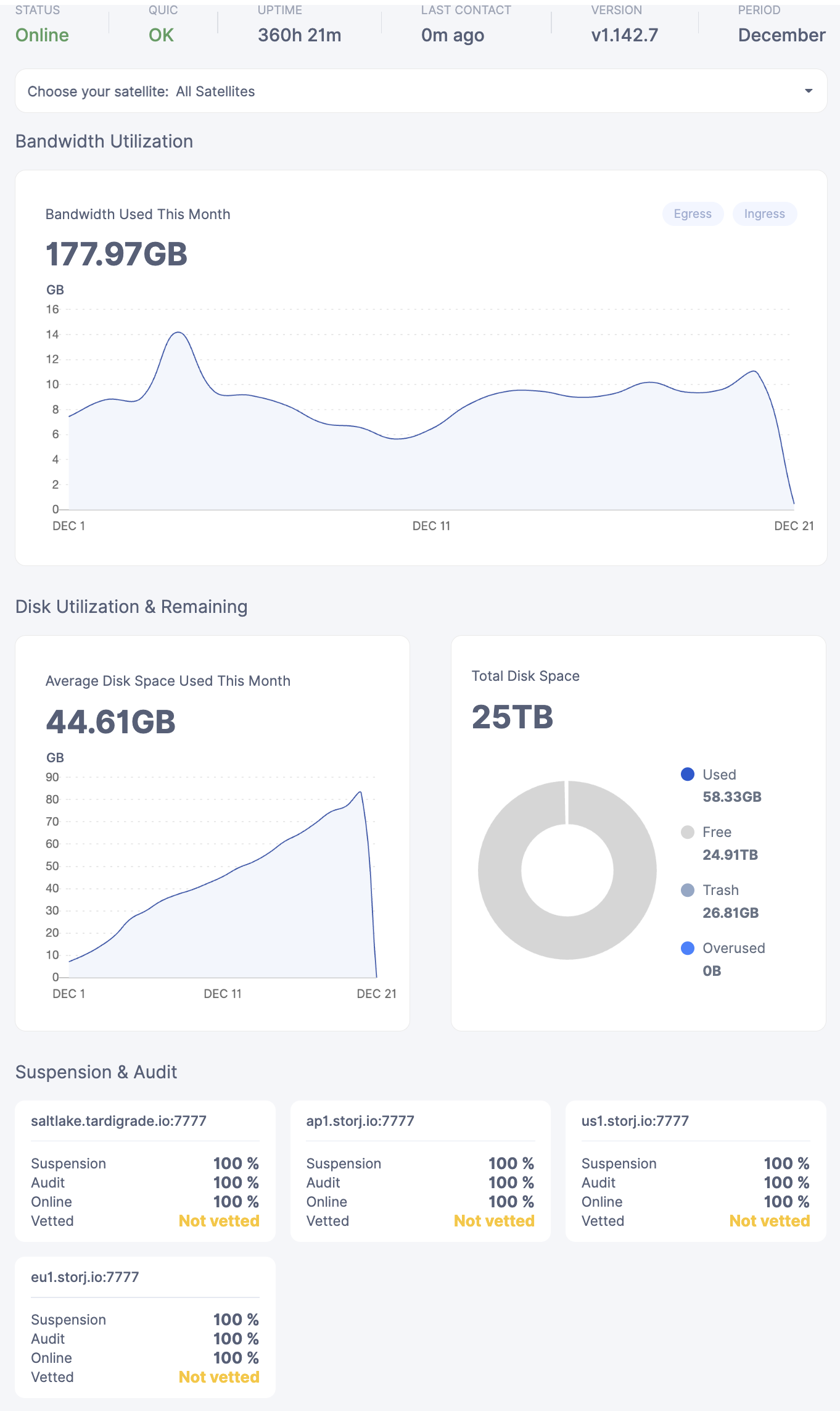

Hello,
I started operating a Storj storage node after having some idle hardware available.
My node was launched on November 29, 2025, and it has maintained 100% online uptime since then.
Below is the current status of my node as shown on the dashboard.
Based on my log analysis, the audit results so far are as follows:
  • AP1 (OK / Fail / Success%): 1450 / 0 / 100%
  • US1 (OK / Fail / Success%): 1517 / 0 / 100%
  • EU1 (OK / Fail / Success%): 597 / 0 / 100%
  • Saltlake (OK / Fail / Success%): 309 / 0 / 100%
All satellites show perfect audit success rates, and the node has been stable and continuously online.
However, the node status is still “Not Vetted.”
Is there any issue with my node that could be delaying vetting?
Approximately when should I expect the node to transition to “Vetted” status?
Thank you in advance for any clarification or guidance.

It should be vetted roughly after December 29, 2025, if it’s a one node in the same /24 subnet of public IPs. If there is more than one such node, then the vetting time can increase by the same number of times as there are such nodes.

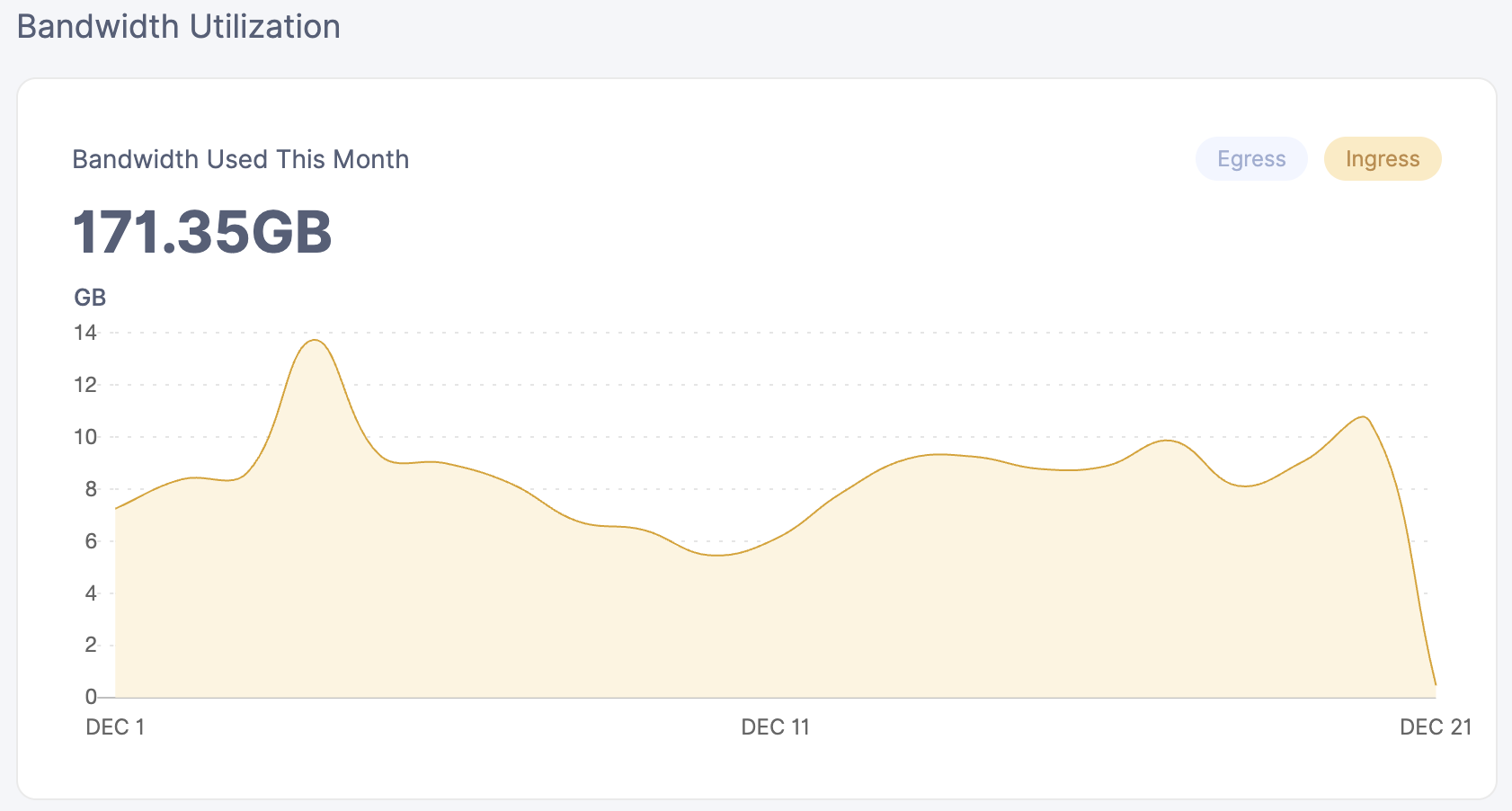

I have noticed significantly less ingress traffic, 10GB/day vs 50-70GB/day for a vetted set of nodes on a /24, which I think is expected given some other changes I saw posted where unvetted were favored a bit more. But also, my vetted nodes are likely skewing my expectations.
