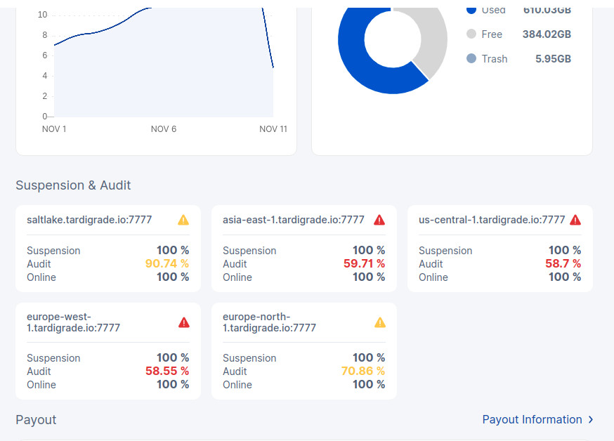

I have two nodes. One has been disqualified on several satellites but I do not know why.
I have found only successful audits on the log and nothing anormal happened.
looks like your disk maybe bad, some data may have been corrupted and then when to many audits hit the bad data your node gets lower audit scores…
there are basically only two ways to fail audits, or atleast i can think of right now.
the data stored is corrupt
the connection to the storage solution is bad, but not completely disconnected.
shutdown the node and run a chkdsk or whatever it’s called, it will most likely show your hdd has failed storing the data correctly.
if so the question is if you want to save the node… seems like saltlake and eu north is still viable… which are most likely the main part of the stored data… so in theory you might be able to GE on those satellites or simply move it to the working hdd.
in which case it might be better to shut it down sooner rather than later, if you want any hope of saving it, you can be offline for like 12 days before getting a suspension… so best to solve the issue with limited uptime, else you might be pretty sure the remaining satellites will also DQ your node, if it wasn’t just a temporary issue… which is ofc possible, and why nerdatwork asked how you connected your drive, because some network or usb setups have … issues…
