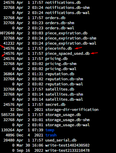

Try also to recreate the pieceinfo.db database, but make a backup of it first.

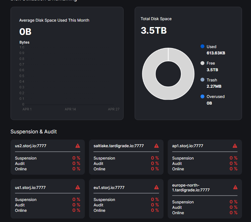

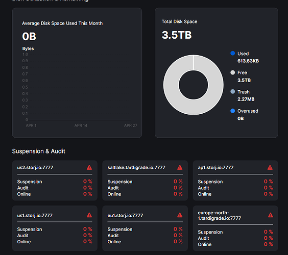

@Alexey I just noticed the pieceinfo.db and piece_spaced_used.db haven’t changed since created, their sizes and modified date remain the same since yesterday. So I think the filewalker is running but not working. ![]()

Well no, no update, the stats keep remain unchanged except for “Trash”. I enabled the debug address :5999 and checked the debug for filewalker(as I posted above), it was running but not working. Actually I can say it’s not working without checking the debug: disk IO & CPU usage remains so calm, if the filewalker really works then it should be skyrocketed. I think I’ll do a GE.

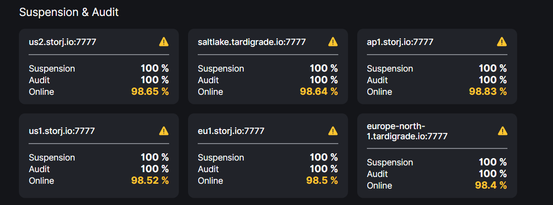

This was exactly the same for me, but after about 1 hour the satellite stats were back.
When I saw this, I just let the node run for 48 hours.
And tadaaaa… Used space was again visible in the dashboard.
Now you have to wait.
With me after 48 hours everything was back, except for the current monthly earnings, but think that is normal by deleting the databases?!
Yes, when you deleting all databases, the history will be lost, it’s stored only on nodes.
