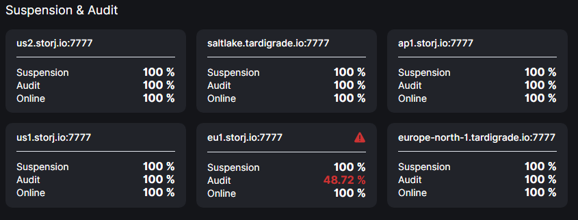

What caused it when I launched a new 16 TB HDD.
Hi @coinbirds - is this a brand new node or did you transfer data from an old HD to a new one? Also what is your node ID?

If this was a second node with the same identity as a first one - both will be disqualified for missed data from another disk. Each node must have an own unique generated identity (only using a different authorization token is not enough).

Yes, this is the second NODE with the same identity.
I deleted the first one due to an error.

It was only active for 2 days so it was easier to do a new node
Since I couldn’t solve the problem I deleted everything and I created a new node with the same “Auth Token”.
What is the solution?
Do I need to delete everything and create a new “Auth Token”?
Do you need a new email address for this?
Thanks in advance
Each node must have an own unique generated identity. So for two nodes you need to create two identities following this guide: Identity | Node Docs
