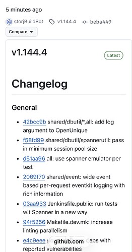

Are you sure, that you used 1.144.4?
It’s not published yet.
Do you maybe meant 1.143.4?

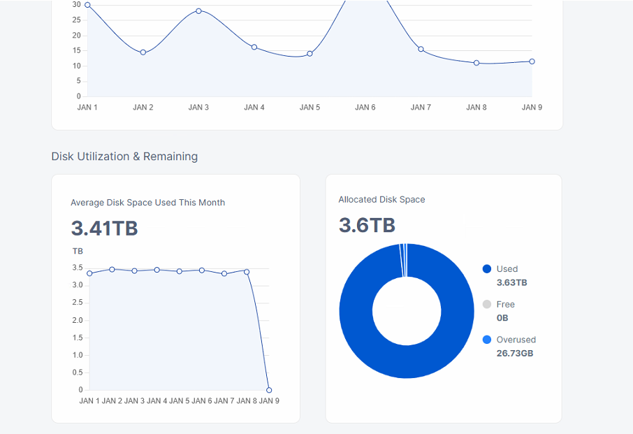

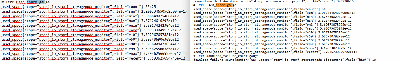

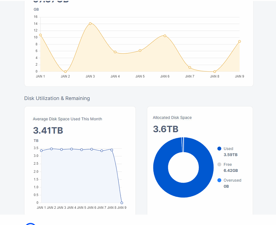

Hello.
Today i made one node restart, before node shown that it has free space, after it show that it has over usage, difference is 30GB in about 2 days. I sended you a pictures and metrict before and after restart to support, asked to forward it to you.
On added picture on left is before restart on right after
here we see that node do not see rising from ingress after previuse overusage was deleted.
here on picture we see ingress on 7-8.01 was alsmost flat, as i restarted node on 7 and there was over usage. after overusege was deleted some old files it got free space, and ingress starts again, but it not stop because node not register new data added.
and today after new restart we see that there is overusage again.
