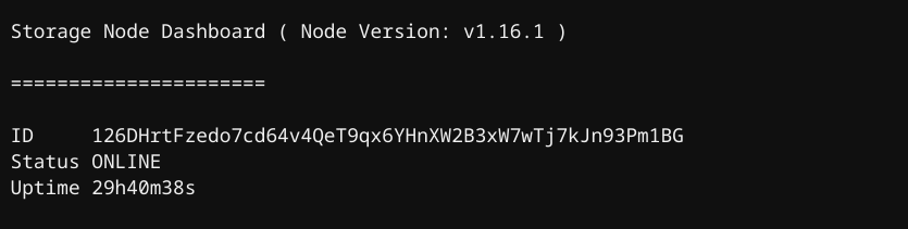

Hey. I was able to fix the reboot issue. the dashboard shows that everything is in order. But the web panel doesn’t work.
ports are open, I have not changed anything in the router settings
