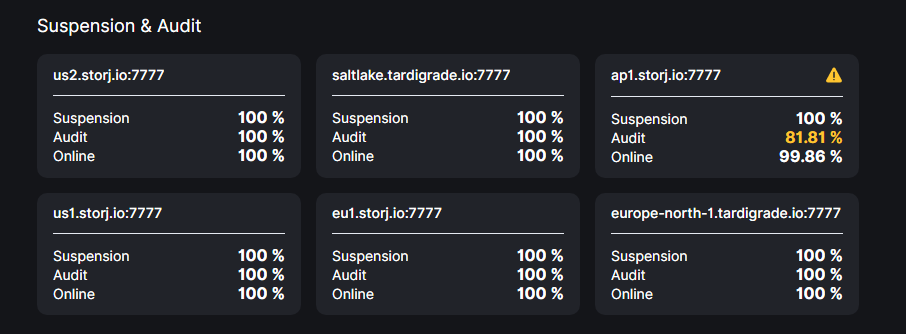

Audit scores dropping on ap1; Storj is working on a fix, SNO's don't need to do anything. ERROR piecedeleter could not send delete piece to trash >> Pieces error: v0pieceinfodb: sql: no rows in result set
So this explains why my logs suddenly exploded. On my bigger node I have seen over 230k entries for “could not send delete piece to trash” in the last 24 hours. Very happy that I have set-up logrotate at this point.
My main node is now at 93.27 % on ap1 and has 21622 pieces that have been deleted successfully and then since failed to delete as they’re already deleted. Of these pieces 3 have been attempted to be audited and failed.
My first piece deleted was:
2021-07-22T20:58:11.444+0100 INFO piecedeleter delete piece sent to trash {"Satellite ID": "121RTSDpyNZVcEU84Ticf2L1ntiuUimbWgfATz21tuvgk3vzoA6", "Piece ID": "222B3CET6VBMUH72OSGSXRQMBNGMHUJPR5AUWVZSC4MX5Z6FMDXA"}
And the first duplicate deletion:
2021-07-22T22:05:06.481+0100 ERROR piecedeleter could not send delete piece to trash {"Satellite ID": "121RTSDpyNZVcEU84Ticf2L1ntiuUimbWgfATz21tuvgk3vzoA6", "Piece ID": "222B3CET6VBMUH72OSGSXRQMBNGMHUJPR5AUWVZSC4MX5Z6FMDXA", "error": "pieces error: v0pieceinfodb: sql: no rows in result set", "errorVerbose": "pieces error: v0pieceinfodb: sql: no rows in result set\n\tstorj.io/storj/storagenode/storagenodedb.(*v0PieceInfoDB).Get:131\n\tstorj.io/storj/storagenode/pieces.(*Store).MigrateV0ToV1:404\n\tstorj.io/storj/storagenode/pieces.(*Store).Trash:348\n\tstorj.io/storj/storagenode/pieces.(*Deleter).deleteOrTrash:185\n\tstorj.io/storj/storagenode/pieces.(*Deleter).work:135\n\tstorj.io/storj/storagenode/pieces.(*Deleter).Run.func1:72\n\tgolang.org/x/sync/errgroup.(*Group).Go.func1:57"}
As Alexey has previously stated, our dev team is already working on resolving this issue. We are very sorry for this incident. No action from SNOs is needed, and there is no need to post more logs at this time. We already have the node IDs affected by this issue so in the event that any of them should get disqualified due to this issue, we will manually reinstate them asap. We will let you know if we have any update. Thank you for your patience.
Thanks for getting back to us from both you and @Alexey ! Good to see you’re all on top of this. Hopefully it won’t cut into your weekends. Let us know if we can do anything else to help.

One small update on this issue. I’m now seeing errors for repairs on these pieces as well. Here’s an example.

this is unlikely to be related to the issue on AP1, if you are seeing similar errors on EU1, please post your log on a new thread, lets keep this one focused on the issue on AP1 thanks.
Thanks for pointing this out - devs are already aware of this, but this will not affect node reputation. They are already working on applying the fix so please stand by.

I have this situation by today morning:
