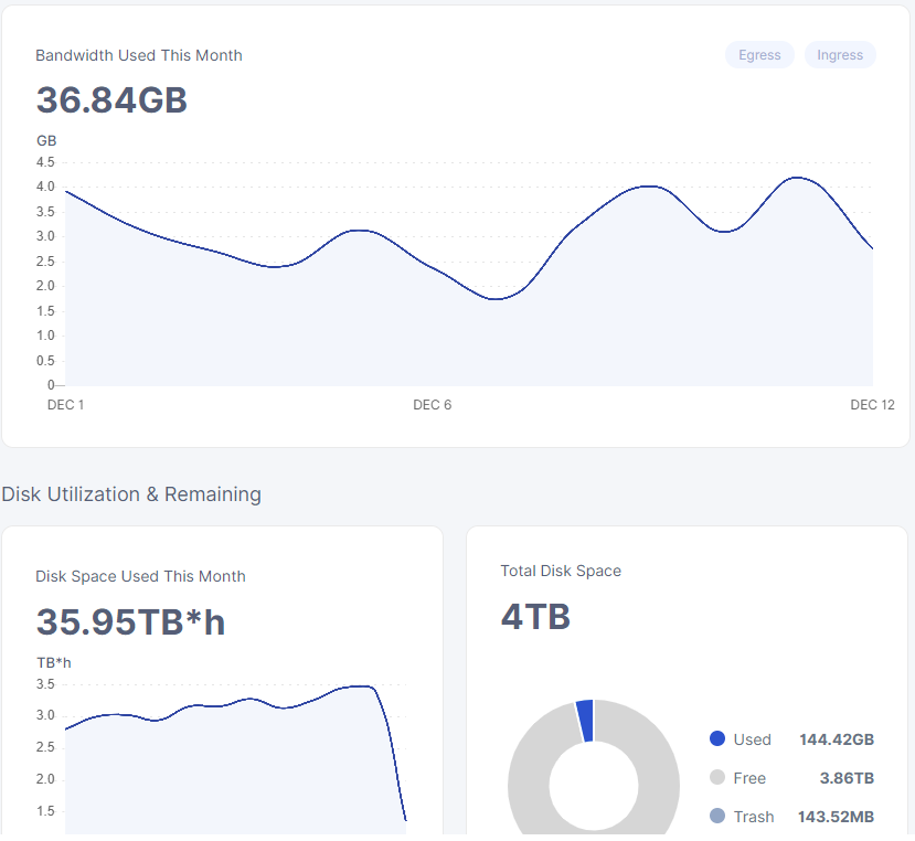

That’s weird, I have almost nothing in the trash on my side ![]()
I do have more repair ingress than regular ingress too though indeed. Dunno if it’s good news for the network… ^^’
But as long as my disks keep filling up, I’m not complaining ![]()

trash is from what i can see is most often when one have large deletes… it’s basically a 7 day or so hold before stuff is deleted to make sure it can be undeleted or something…
not sure if all deletes goes in to trash either… been told how it works a few times, but i doesn’t seem to have stuck… or maybe it wasn’t a clear easy to understand answer ![]()

They don’t. Normal deletes go to your node and show up as a delete. Those will be removed from your HDD right away. Trash usually accumulates when your node has been offline or has timed out on the deletes when they were sent to them. In the past we’ve had some zombie segment cleanups on the satellite that lead to trash being used as well. But as far as I can tell that hasn’t happened in a long time. So my trash has been basically empty for months now.

yeah my trash did show up after my isp change related downtime.

so the idea with the trash is that if the repair is initiated again, it can revive the trash from nodes that initially held the data…thus saving on repair costs maybe…
that would sort of make sense, and also help distribute the data across nodes in the network in different locations…
hopefully my downtime will not to be extensive any more…
thanks for setting it straight… ill try to remember this time lol
I missed one common scenario. If data is repaired and moved to other nodes while your node is offline it will end up in trash on your node as well.
The idea behind it has to do with how garbage collection works. Garbage collection uses a bloom filter, which you can see as a set of instructions to select pieces. Bloom filters match all pieces that should be on your node (and some that shouldn’t be, it’s not a perfect system). So your node moves all pieces that don’t match the bloom filter to trash. The reason they aren’t removed entirely right away is just to catch situations where by accident an empty bloom filter is sent or a faulty bloom filter. That would instantly end your node if it happened. But the trash allows the node to recover from such a mistake if needed.
With normal operation, trash is never restored. So no, it’s not about repair costs.

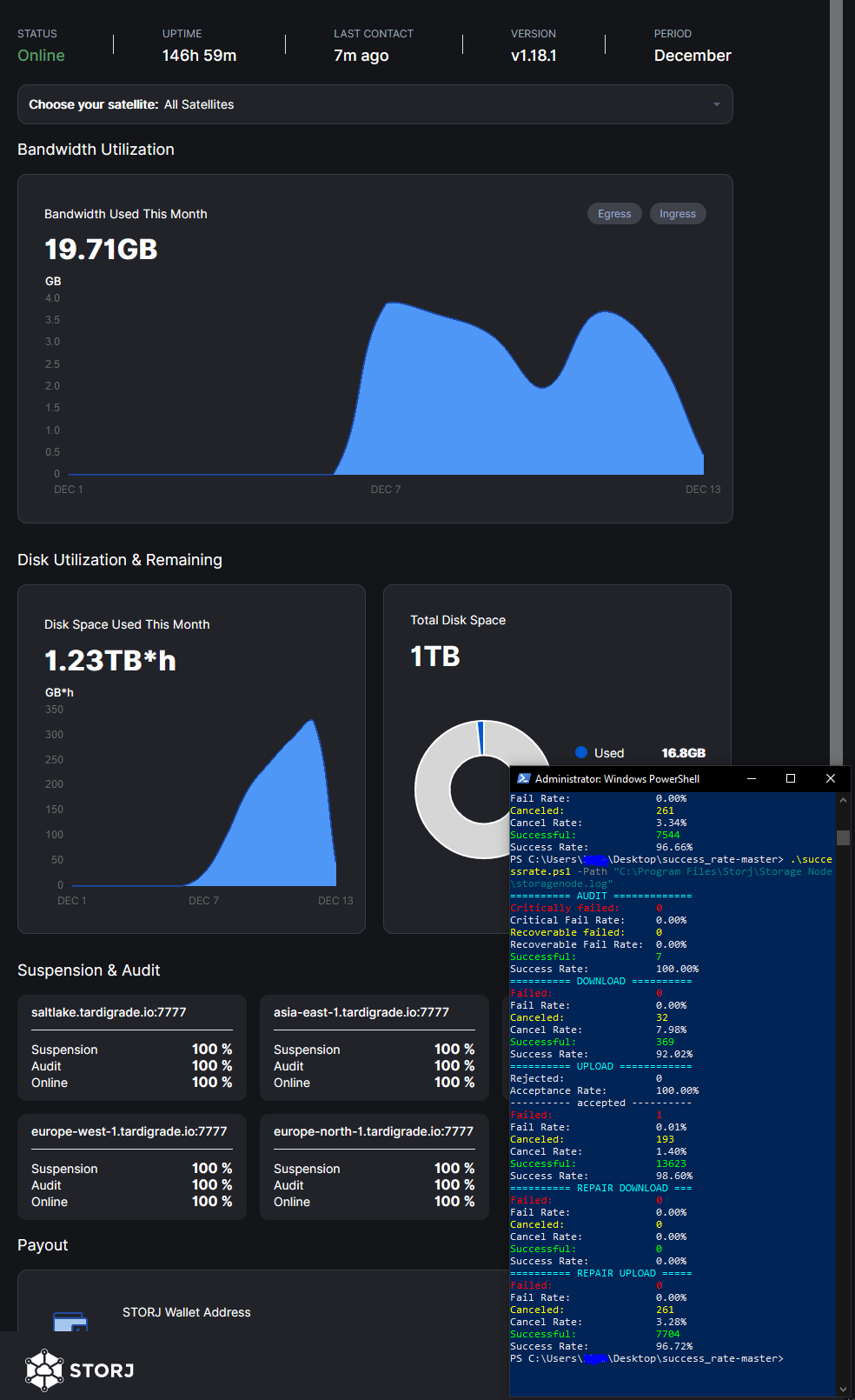

no. Vetted nodes get 95% of global traffic, unvetted nodes 5%.
(You even answered directly below my post linking to that answer in a different thread… Ingress traffic splitting between vetted and non-vetted node on same subnet - #8 by SGC)
that might actually explain why my 2 month old node isn’t vetted yet and why coldsc
has only 7 audits over a week.
if global traffic is fixed at 5% for vetted nodes, and there have been an increase of 3000 nodes over the last quarter… that could essentially stall the vetting of new nodes due to the global traffic remaining the same, but the number of nodes going up by 5 fold…
that would mean that ingress is about to drop like a stone when all the nodes vetting comes online…
only reason why vetting would take months is because there is an insane amount of nodes being vetted.
not a good prediction that…
wonder if they made it that way… the 5% of global instead of subnets to ensure a slow growth of the network, because it would create a sort of static amount of new nodes that can vet in a certain time equal to the total ingress / repair ingress on the network.
thus if the network grows faster it will vet more nodes faster and if its not growing node vetting will slow down…
