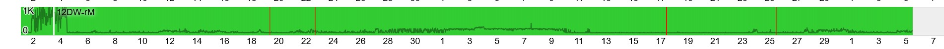

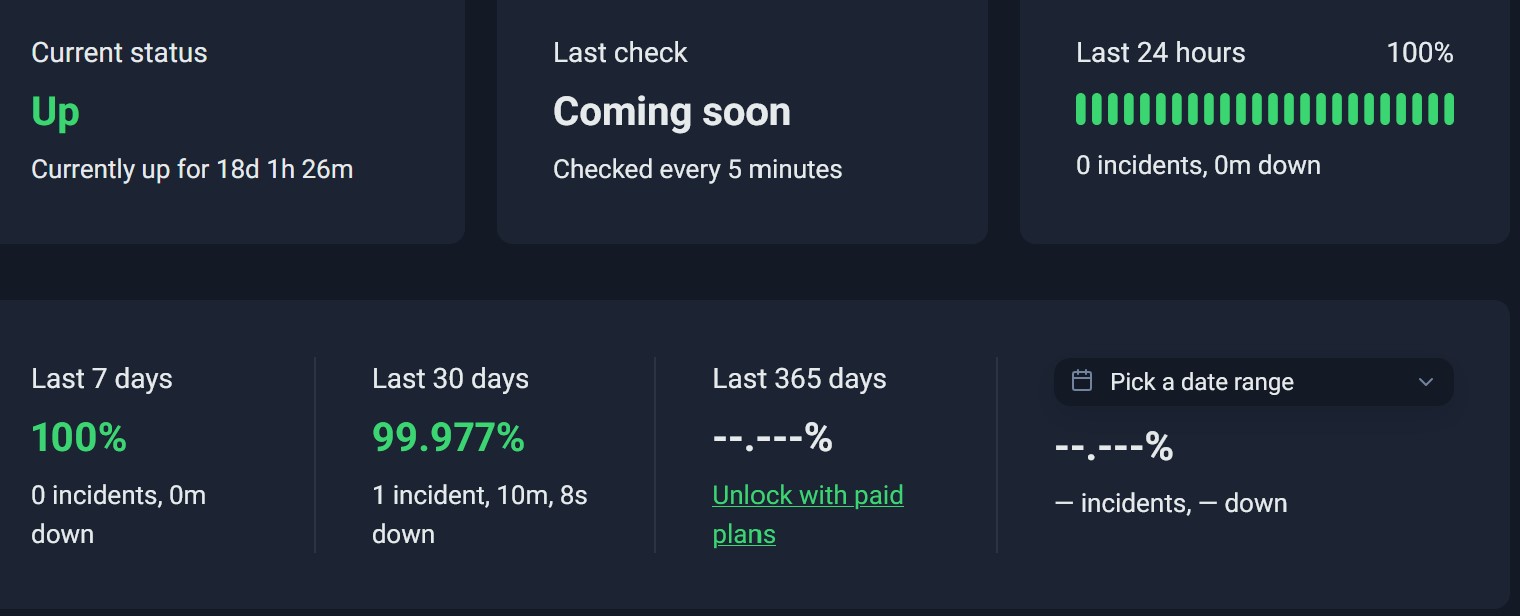

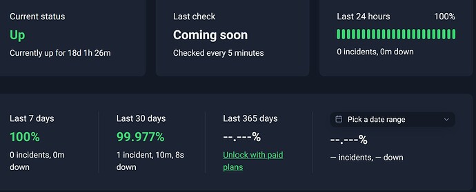

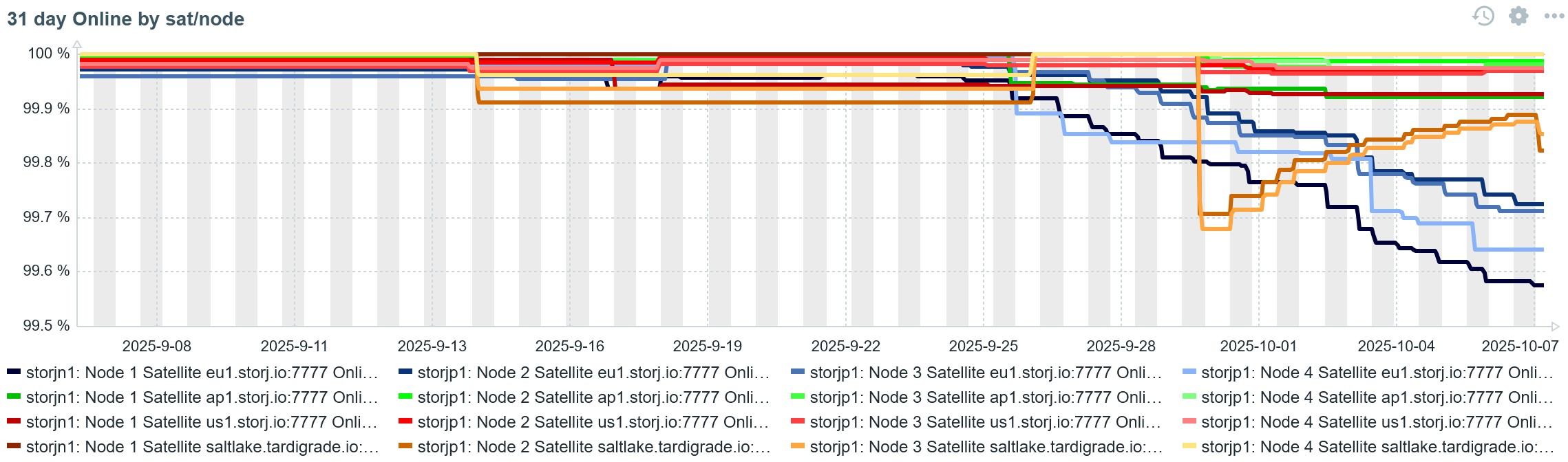

I have the same (or very similar) thing too - on all my four nodes (made up from two hosts, one public IP)
I only have uptime robot on one:
From storjnet.info:
API output logged via zabbix:
This is affecting all four nodes similarly, but only for eu1
