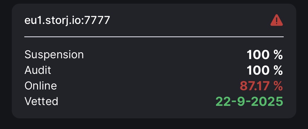

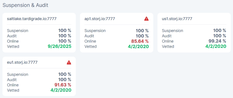

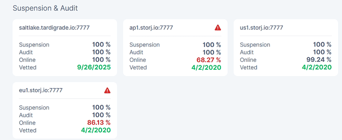

alarmed with this tread i checked my nodes,
some have EU stats loosing up to 94-90%, and some saltlake too, and US and AP in norm (98%) i will monitor situation, but my blind guess basted on some old observations with uptimerobot is this: online audit gets rejected when traffic hits like last weeks. i will check later and compare. and post results.
(nodes are in EU countries)
But traffic no longer hits like last week and stats continue to drop. This means it is still happening.

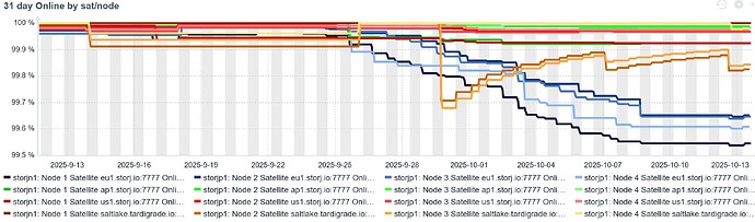

Considering online score is measured as an average over the last 30 days and assuming my online score was 100% for the days 18 days before 26 September and considering my online score now is 99.58%, I deduce that for the last 12 days the average online score would be 99.20% in my case. If things continue as they are now, I will probably see my online score converge to this value. Not a big problem, but strange this affects EU1 only nonetheless.

auditor instance has been moved recently between cloud providers.
There is a small change – but still possible – that the network of the new provider is not as reliable as the old one (GCP), and as we think it is.
To further debug this issue, I moved back EU1 auditor to GCP (and planning to do the same with AP1). Let’s wait a few days and check if it helps…

Please check the audits history with the scripts above - is there an improvement?
In my case EU1 score is now stable. It has not dropped since you made that change.

It is probably a bit early to be certain, but the change Elek made 2 days ago is looking promising - no drops since then.
Will report back again in a couple more days
There is a confirmation of the online score growing from the linked thread:
Yeah, seems to be going up now :slight_smile:
Not really going up yet - I expect we’ll have to wait a couple more weeks for that, but certainly less decline
I can confirm as well.
