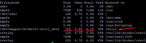

After storage node update to v0.31.9 I see this warning in log:
2020-01-30T09:11:33.179673871Z 2020-01-30T09:11:33.179Z INFO piecestore:monitor Remaining Bandwidth {"bytes": 319215795429120}
2020-01-30T09:11:33.179799004Z 2020-01-30T09:11:33.179Z WARN piecestore:monitor Disk space is less than requested. Allocating space {"bytes": 6704352774912}
2020-01-30T09:11:33.257962522Z 2020-01-30T09:11:33.257Z INFO version running on version v0.31.9
df -h
(3.9+6.1= 10T)
df
Docker run have -e STORAGE="10TB"
So, calculation used space+freespace is wrong?
I changed docker run to -e STORAGE="7TB" and recreate storage node, but warning is the same.
So, it definitely bug in space calculations (free + already used by storage node )
