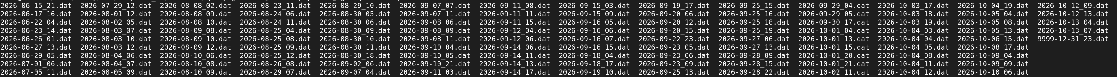

Unless a lot of .dat files appeared in the piece_expirations folder.
Could you please elaborate?

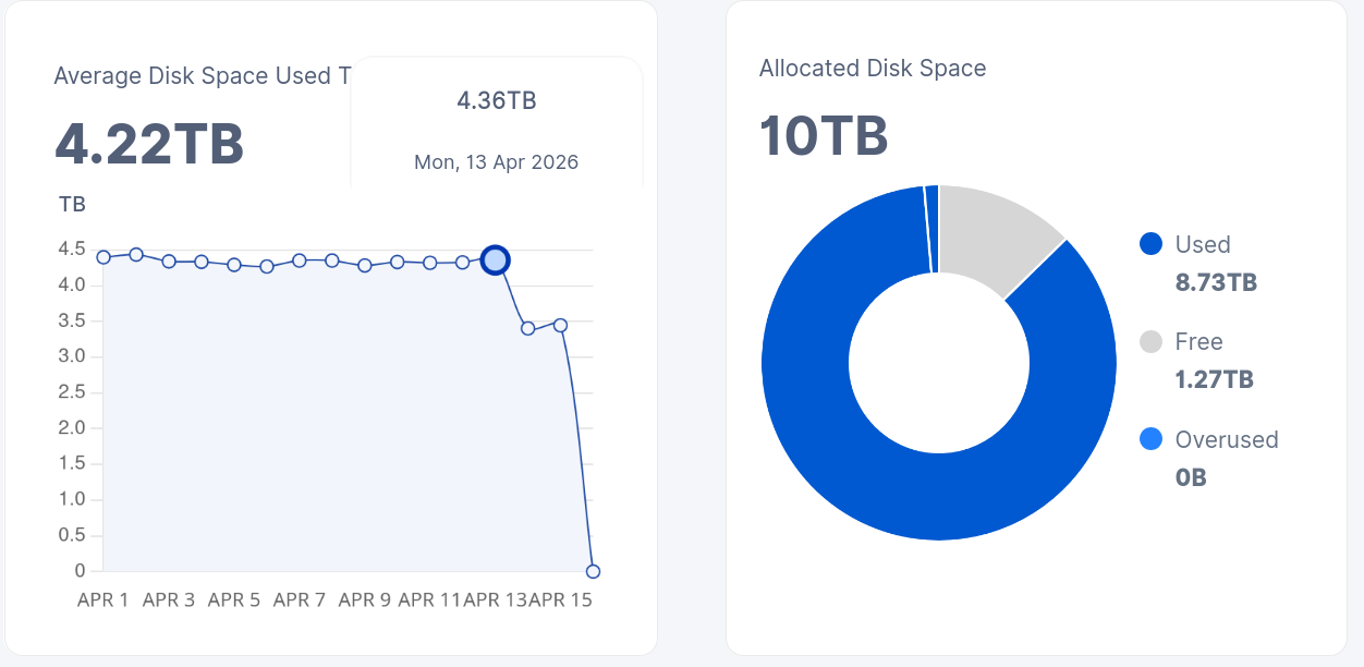

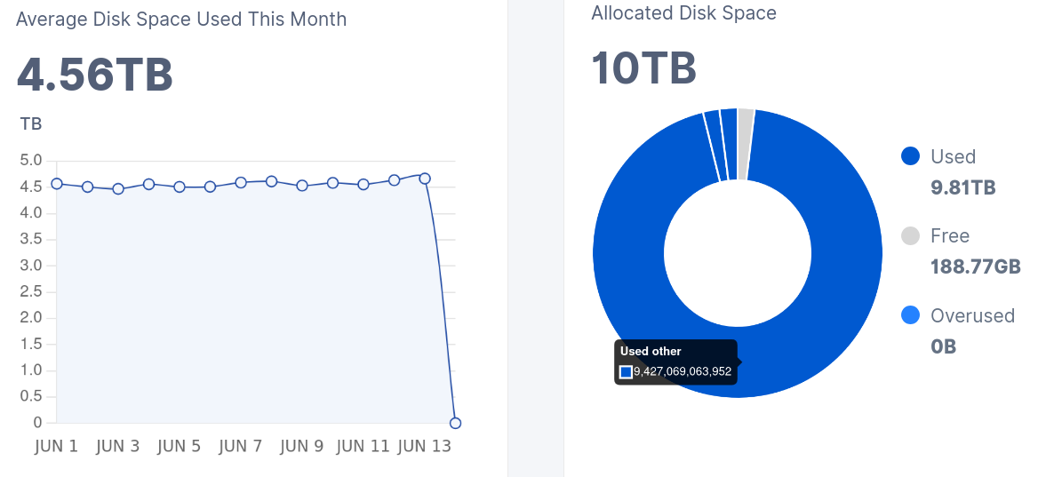

I have one node where the “Average Disk Space Used this Month” differs significantly from the actual disk usage. I tried deleting DB files and waiting for several runs of the garbage collector, but the unused space still isn’t freed. I checked — data from old test satellites has been removed. Remaining: 4 folders (saltlake, ap1, us1, eu1).

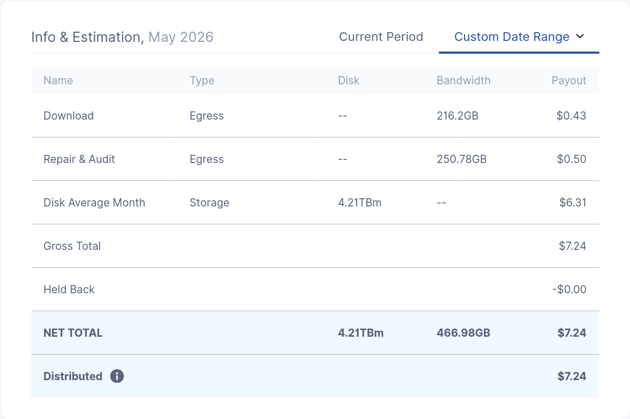

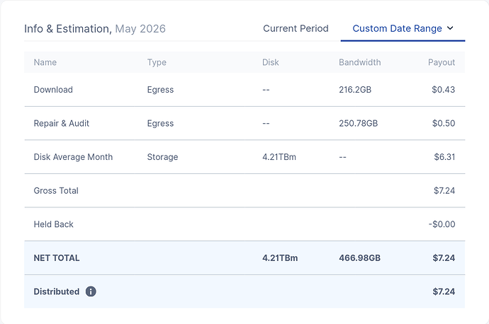

What’s your last payout says about used space?
