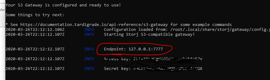

@jennifer I have the same problem as i had in I need help to acces ./gateway_linux_arm run outside my container
Can you pleas give me a hint how I configure the container tha I can access the gateway not only from local host?

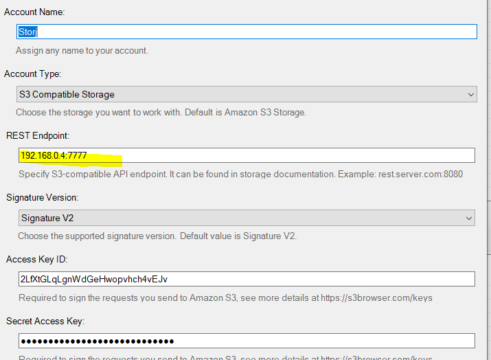

@kevink I forward the port 7777. But I have no acces from my PC. E.g my NAS have the IP 192.168.0.4
and I try to access from my PC via S3 Browser Tardigrade. But it does not work
if you forward port 7777 in docker like -p 0.0.0.0:7777:7777 it should work. but I only know about normal docker, not qnap.
@kevink No doesn´t work. Mybee it is the same issue like here. I need help to acces ./gateway_linux_arm run outside my container - #3 by jensamberg . But how can I reconfigure the docker container thet the S§ gateway not only listen to localhost?
then you might need to edit that config.yaml inside the docker container.

You need to edit the config.yaml and change the address to 0.0.0.0:7777.
By default it only listens to local host, so port mapping on the container alone isn’t enough.
Or specify the --server.address=":7777" after the image name in the docker run command
docker run -it -p 7777:7777 storjlabs/gateway:f71bc3f-v1.0.0-go1.13.8 --server.address=":7777"
