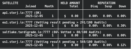

I’ve added a feature that considers the new vetting status as reported by the satellite. This will help show whether your node is considered vetted by the satellite independent of the number of reported successful audits.
This prevents the earnings calculator from just assuming your node has been successfully vetted after 100 successful audits. If for some reason your node is not considered vetted after 100 audits are completed it will show up like this.
However, as I don’t have any nodes in vetting phase currently, it would be helpful if someone could test this new version. I’ve tested by simulating the situation, but I’d like to have some actual testing. I’m looking for 2 scenarios specifically:
  • Node is being vetted
  • Node should have been vetted long ago but isn’t (shows the above message)
If you want to help test, you can find the new version here: https://raw.githubusercontent.com/ReneSmeekes/storj_earnings/refs/heads/feature/satellite_vetting_result/earnings.py
Please post a screenshot of at least the satellite overview and provide any feedback you can.
Here are the screenshots you asked for:
First some infos:
The node (Labeled: Node1) is one out of four behind the same IP, here you can see the traffic of this four nodes:
      Egress      Ingress
Node1  18.358 GB  104.679 GB (Node with vetting issue)
Node2 134.191 GB  180.800 GB (vetted Node)
Node3  39.614 GB  180.414 GB (vetted Node)
Node4  11.606 GB  161.514 GB (new Node, vetted on EU1 and US1, AP1 38/100 audits)
The ingress for this Node1 is significant lower compared to the other three.
Node1:``
July 2025 (Version: 14.2.0)                                             [snapshot: 2025-07-18 10:40:32Z]
REPORTED BY     TYPE      METRIC                PRICE                     DISK  BANDWIDTH        PAYOUT
Node            Ingress   Upload                -not paid-                       81.76 GB
Node            Ingress   Upload Repair         -not paid-                        3.68 GB
Node            Egress    Download              $  2.00 / TB (avg)                9.74 GB       $  0.02
Node            Egress    Download Repair       $  2.00 / TB (avg)                5.37 GB       $  0.01
Node            Egress    Download Audit        $  2.00 / TB (avg)              261.12 KB       $  0.00
Node            Storage   Disk Current Total    -not paid-             0.00  B
Node            Storage              β”œ Blobs    -not paid-             0.00  B
Node            Storage              β”” Trash  ┐ -not paid-             0.00  B
Node+Sat. Calc. Storage   Uncollected Garbage ─ -not paid-           -175.72 GB
Node+Sat. Calc. Storage   Total Unpaid Data <β”€β”˜ -not paid-           -175.72 GB
Satellite       Storage   Disk Last Report      -not paid-           175.72 GB
Satellite       Storage   Disk Average So Far   -not paid-           172.07 GB
Satellite       Storage   Disk Usage Month      $  1.49 / TBm (avg)   79.27 GBm                 $  0.12
________________________________________________________________________________________________________+
Total                                                                 79.27 GBm 100.56 GB       $  0.15
Estimated total by end of month                                      172.07 GBm 178.69 GB       $  0.32
Payout and held amount by satellite:
β”Œβ”€β”€β”€β”€β”€β”€β”€β”€β”€β”€β”€β”€β”€β”€β”€β”€β”€β”€β”€β”€β”€β”€β”€β”€β”€β”€β”€β”€β”€β”€β”€β”€β”¬β”€β”€β”€β”€β”€β”€β”€β”€β”€β”€β”€β”€β”€β”¬β”€β”€β”€β”€β”€β”€β”€β”€β”€β”€β”€β”€β”€β”€β”€β”€β”€β”€β”€β”€β”€β”€β”€β”€β”€β”€β”¬β”€β”€β”€β”€β”€β”€β”€β”€β”€β”€β”€β”€β”€β”€β”€β”€β”€β”€β”€β”€β”€β”€β”€β”€β”€β”€β”€β”€β”€β”€β”€β”€β”€β”€β”€β”€β”€β”€β”€β”€β”€β”€β”€β”€β”€β”€β”€β”€β”€β”€β”€β”€β”€β”€β”€β”€β”€β”€β”€β”€β”€β”
β”‚ SATELLITE                      β”‚ HELD AMOUNT β”‚        REPUTATION        β”‚                       PAYOUT THIS MONTH                     β”‚
β”‚              Joined     Month  β”‚      Total  β”‚    Disq    Susp    Down  β”‚    Storage      Egress  Repair/Aud        Held      Payout  β”‚
β”œβ”€β”€β”€β”€β”€β”€β”€β”€β”€β”€β”€β”€β”€β”€β”€β”€β”€β”€β”€β”€β”€β”€β”€β”€β”€β”€β”€β”€β”€β”€β”€β”€β”Όβ”€β”€β”€β”€β”€β”€β”€β”€β”€β”€β”€β”€β”€β”Όβ”€β”€β”€β”€β”€β”€β”€β”€β”€β”€β”€β”€β”€β”€β”€β”€β”€β”€β”€β”€β”€β”€β”€β”€β”€β”€β”Όβ”€β”€β”€β”€β”€β”€β”€β”€β”€β”€β”€β”€β”€β”€β”€β”€β”€β”€β”€β”€β”€β”€β”€β”€β”€β”€β”€β”€β”€β”€β”€β”€β”€β”€β”€β”€β”€β”€β”€β”€β”€β”€β”€β”€β”€β”€β”€β”€β”€β”€β”€β”€β”€β”€β”€β”€β”€β”€β”€β”€β”€β”€
β”‚ ap1.storj.io:7777 (OK)         β”‚             β”‚                          β”‚  $  1.49/TBm $  2.00/TB  $  2.00/TB       50%         50%   β”‚
β”‚              2025-03-31     5  β”‚   $   0.02  β”‚   0.00%   0.00%   0.00%  β”‚  $  0.0053   $  0.0003   $  0.0036  -$  0.0046   $  0.0046  β”‚
β”‚ eu1.storj.io:7777 (OK)         β”‚             β”‚                          β”‚  $  1.49/TBm $  2.00/TB  $  2.00/TB       50%         50%   β”‚
β”‚              2025-03-31     5  β”‚   $   0.03  β”‚   0.00%   0.00%   0.21%  β”‚  $  0.0053   $  0.0011   $  0.0054  -$  0.0059   $  0.0059  β”‚
β”‚ us1.storj.io:7777 (Vetting result pending > 3779/100 Audits)            β”‚  $  1.49/TBm $  2.00/TB  $  2.00/TB       50%         50%   β”‚
β”‚              2025-03-31     5  β”‚   $   0.43  β”‚   0.00%   0.00%   0.00%  β”‚  $  0.1075   $  0.0180   $  0.0017  -$  0.0636   $  0.0636  β”‚
β”œβ”€β”€β”€β”€β”€β”€β”€β”€β”€β”€β”€β”€β”€β”€β”€β”€β”€β”€β”€β”€β”€β”€β”€β”€β”€β”€β”€β”€β”€β”€β”€β”€β”Όβ”€β”€β”€β”€β”€β”€β”€β”€β”€β”€β”€β”€β”€β”Όβ”€β”€β”€β”€β”€β”€β”€β”€β”€β”€β”€β”€β”€β”€β”€β”€β”€β”€β”€β”€β”€β”€β”€β”€β”€β”€β”Όβ”€β”€β”€β”€β”€β”€β”€β”€β”€β”€β”€β”€β”€β”€β”€β”€β”€β”€β”€β”€β”€β”€β”€β”€β”€β”€β”€β”€β”€β”€β”€β”€β”€β”€β”€β”€β”€β”€β”€β”€β”€β”€β”€β”€β”€β”€β”€β”€β”€β”€β”€β”€β”€β”€β”€β”€β”€β”€β”€β”€β”€β”€ +
β”‚ TOTAL                          β”‚   $   0.47  β”‚                          β”‚  $  0.1181   $  0.0195   $  0.0107  -$  0.0742   $  0.0742  β”‚
β”‚ ESTIMATED END OF MONTH TOTAL   β”‚   $   0.60  β”‚                          β”‚  $  0.2649   $  0.0346   $  0.0191  -$  0.1593   $  0.1593  β”‚
β””β”€β”€β”€β”€β”€β”€β”€β”€β”€β”€β”€β”€β”€β”€β”€β”€β”€β”€β”€β”€β”€β”€β”€β”€β”€β”€β”€β”€β”€β”€β”€β”€β”΄β”€β”€β”€β”€β”€β”€β”€β”€β”€β”€β”€β”€β”€β”΄β”€β”€β”€β”€β”€β”€β”€β”€β”€β”€β”€β”€β”€β”€β”€β”€β”€β”€β”€β”€β”€β”€β”€β”€β”€β”€β”΄β”€β”€β”€β”€β”€β”€β”€β”€β”€β”€β”€β”€β”€β”€β”€β”€β”€β”€β”€β”€β”€β”€β”€β”€β”€β”€β”€β”€β”€β”€β”€β”€β”€β”€β”€β”€β”€β”€β”€β”€β”€β”€β”€β”€β”€β”€β”€β”€β”€β”€β”€β”€β”€β”€β”€β”€β”€β”€β”€β”€β”€β”˜

New version today to incorporate new conditions for vetting. In addition to requiring a minimum number of audits, it now also requires a certain node age. If Storj is sticking to release defaults (which they usually do, but I asked for confirmation in the linked topic), that means nodes need to have 100 successful audits as well as be at least 504 hours (21 days) old.
More info on the change here: What is the new vetting time? - #6 by elek
Vetting progress now shows the progress on the requirement you’re most behind on. This usually results in all satellites showing the same progress percentage as the time condition is now usually the one holding your node back. But in this screenshot of a very new node, you can see if the count is behind and might cause vetting to take longer than 21 days, the original calculation for progress is used.
As always you can download the latest version using instructions in the top post.
Changelog
v14.3.0 - Consider minimum vetting time for vetting progress
  • Vetting now takes a minimum amount of time in addition to a minimum number of audits. The progress percentage now reflects both conditions and displays the progress on the condition that is most behind.
  • Several small changes to make stats visible faster after starting a new node. If no data shows up, it’s usually fixed after restarting your node once it has received some data.
It’s about 600 hours (or may be it’s counting 21 day and after that starts to count audits)
