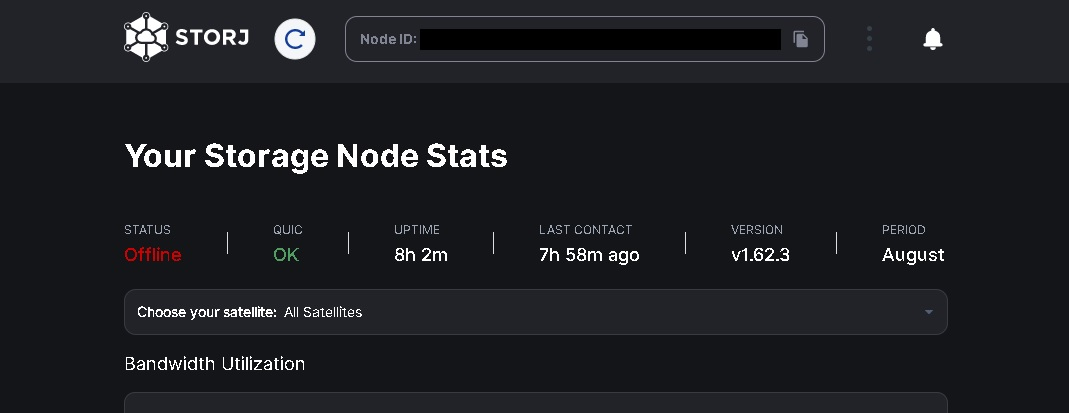

So I was just checking the web interface when I noticed my nod was reporting to be offline?
- I refreshed the webpage - Same (still offline)
- I restarted my ProxMox VM that runs my node…
- I came into the same problem as my previous thread (as described here )
- Followed @CutieePie 's solution, which worked once again.
- Refreshed the web interface url, and upon doing so saw this on the console…
[https://i.postimg.cc/gkP48m85/console attitional info.jpg](https://i.postimg.cc/gkP48m85/console attitional info.jpg)
[https://i.postimg.cc/sx5cqNdw/node status offline.jpg]
(https://i.postimg.cc/sx5cqNdw/node status offline.jpg)
Please help '-)

Unfortunately I can’t help with the error. It looks like a firewall issue as the node is running but says ‘Offline’.
Check log file for more information on the error.

To me, it looks like its doing what it’s supposed to?
Yet still says ‘OFFLINE’ ??
EDIT : Just noticing the time and date stamps, wierd the time is off but that says I’ve just done ‘one’ so am I actually working in-fact?
Stob
#6
Agreed, logs look fine.
Have you tried a Ctrl+F5 in the browser, to clear the cache?
Unfortunately yes… weird huh

Please try to use a different browser.
Or try to run a CLI dashboard.
Very strange…
Solved, thanks for your help guys
EDIT : Under Windows 11, using both Chromium and Edge they both say OFFLINE, using Windows 10 and Chromium it says ONLINE - WTF?!?!

Extensions, cookies configuration, security restrictions, and so on.
You may try to clear the cache and cookies in browsers in Windows 11.
