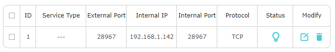

Thank you for the list. The IP listed on yougetsignal.com does not match the router IP. However, I did use NoIP DUC. I have completely turned off Windows Firewall. So maybe I am thinking there could be an issue with the port forwarding that I set up in the router? (attached screenshot of forwarding setup in router)
Any chance that connecting via VPN could be causing issues? I’ve followed the guide on firewall, and just still not seeing that the port 28967 is “open” status.
The NoIP doesn’t help, if your WAN IP doesn’t match your public IP.
If you want to use VPN, you should use VPN with port forwarding option such as portmap.io, ngrok, PIA, AirVPN, PureVPN, etc.
Each of them offer a different method to forward the port, some of them offer a hostname, thus you would not need a NoIP.

You need to check the WAN IP on your router, not DNS IP Address. The WAN IP must match the public IP, this is the only way to make port forwarding work.
If they do not match, then you have a few options:
- call to your ISP and ask them to give you a public IP, it could be dynamic, but must be a public (WAN IP matches IP on yougetsignal); you can say to their support that you want to have an access to your security IP cam, with this you would not need to explain Storj;
- switch the ISP to one, who offer a public IP;
- use VPN with port forwarding option (the ExpressVPN do not offer it except flashing firmware to your hardware router).
