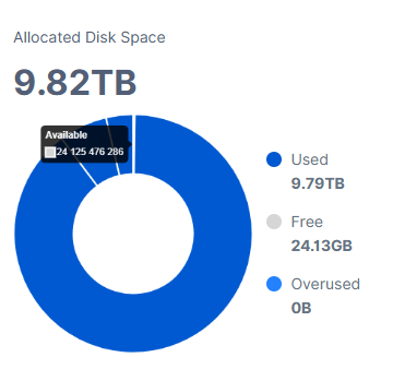

As it was mentioned somewhere else on the forum, the dedicated disk functionality is deprecated. Based on this I did switch back to standard space accounting on nodes that do run hashstore (I do not run piecestore anymore).
After the switch some of the nodes are reporting as they are out of free space, where in fact there is space available (one example):
Some of the nodes are facing the opposite problem - they did under report the used space, causing the nodes to be unable to start, complaining there is no free space left on the device.
These are all configured with storage.allocated-disk-space: 100 TB.
The databases for these nodes are on separate drives and there is nothing else using the space on the partition.
The directories with the original piecestore were all deleted a long time ago, as were files in trash and garbage directories.
These are all running ext4.
Not sure how the accounting is done on hashstore, and if any kind of a startup scan is needed, but this was exactly the issue we were facing with piecestore and its accounting.
I had zero such problems when on dedicated disk.
Any quick solution for this? As these are supposed to be maintenance free as we know.
Thank you!
