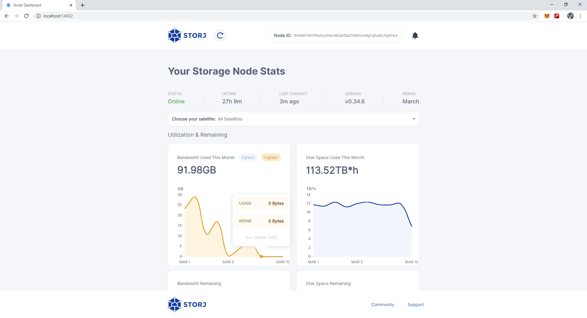

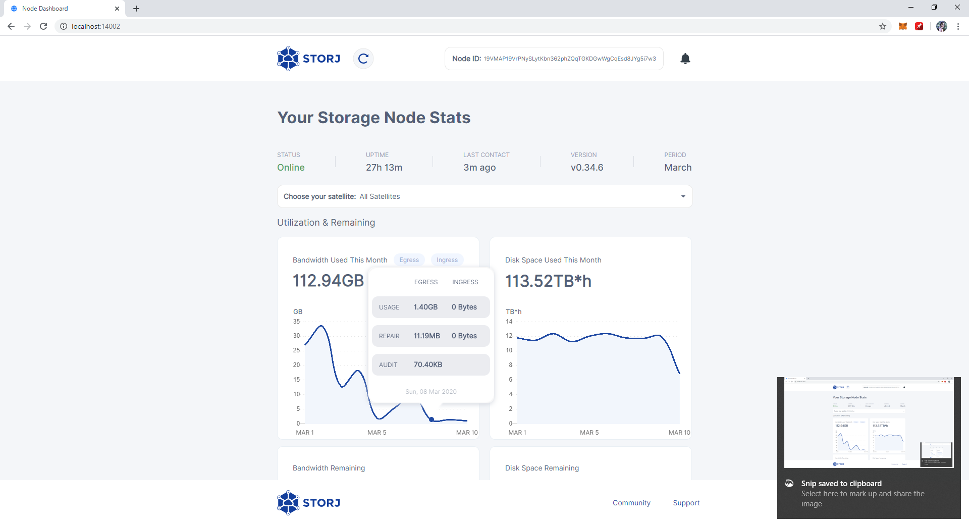

So what is happening right now? I have the egress traffic, but zero ingress right now.
For today it shows 0 doesnt mean anything, it doesnt show it right away.
It is not for today only. It is zero for 3 days in a row.
But it shows your node is only online for 27 Hours.
That is because it was updated at that time.

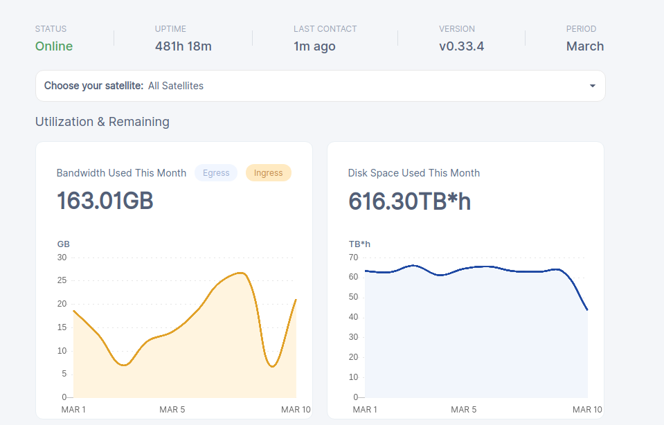

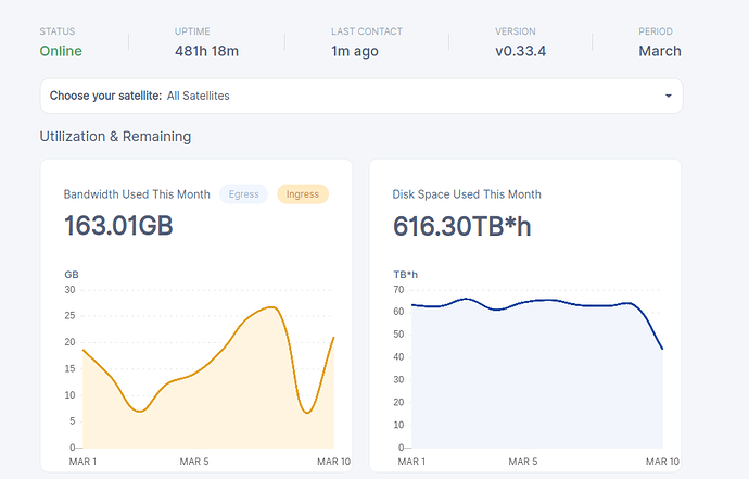

So I see this for the first time ever, 3 days in a row with zero ingress. At 8 of march I did run the exit command. I don`t think it is just a coincidence.
