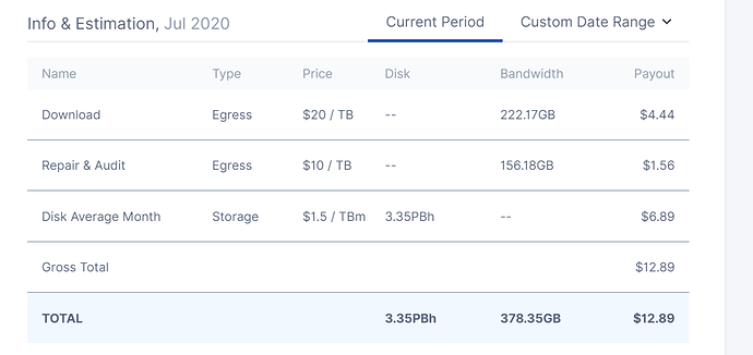

Going by your disk usage your node is at about 10TB used. We’re not even halfway through the months and you made 12.89. You’re going to go over 2.50 per TB per month from the looks of it.
He means
$1.5 per TB STORAGE + 5%(observed) of that 1TB(50GB)EGRESS = 1.5 + 1 = 2.5USD/TB
