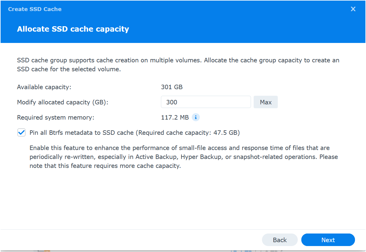

Just if anyone is curious about how metadata cache works on Synology, I discovered this recently and find it interesting:
  1. Installed two NVMe WD Red 1 TB SSD sticks
  2. Allocate SSD Cache capacity (I split the capacity between all HDDs)
  3. Pin all BTRFS metadata to SSD cache (RAM requirement also listed)
  4. It provides some size recommendation

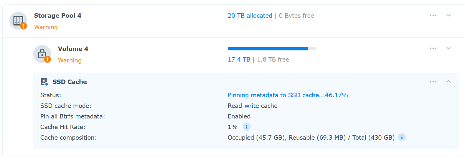

  5. Pinning takes some 20 minutes
  6. It looks like initial filewalker is utilizing the cache greatly, while the HDDs are doing almost nothing
