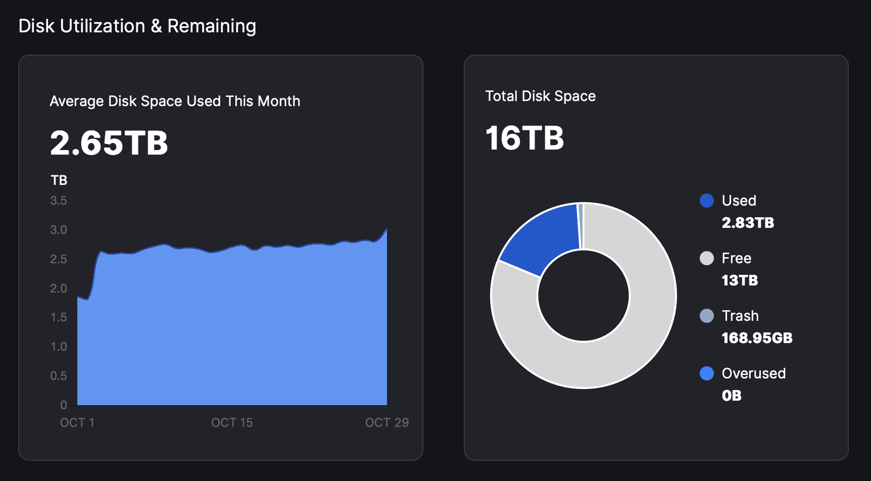

Then I noticed that the node was showing about twice as much used space as it actually had.
As suggested, I stopped the node, deleted the used_space_per_prefix.db, and restarted the node.
Now the correct value seems to be there (I haven’t double-checked it yet, but it has roughly halved).
What I don’t understand, however, is why the used space filewalker no longer starts?
The lazyfilewalker.trash-cleanup-filewalker runs as usual, but not the used space filewalker.

The migration is complete. Do I now have to undo the entries as described in the first post?
Please ignore the “\” in the logs and the compose. They seem to come from copying.
There is no need for it now node is using hashstore. Deleted blobs (located in trash folder) are not converted, so they will hang around until the node deletes them (upto 7 days after conversion).
Yes, but only the 4x *.migrate_chore files. Set them back to false.
Is it necessary? I didn’t change them back (didn’t know I should) and node LOOKS to me like working. What is bad of letting them as they are?
Not necessary. Stops a log entry every 10 minutes about queuing migration, and an io spike as the node searches blobs folder for anything to migrate.
Are you sure that the used space filewalker is no longer needed?
Then the used disk space should match the dashboard, but it doesn’t.
du -h --si --max-depth=2
4.1k	./blobs
4.1k	./trash/v4weeab67sbgvnbwd5z7tweqsqqun7qox2agpbxy44mqqaaaaaaa
4.1k	./trash/qstuylguhrn2ozjv4h2c6xpxykd622gtgurhql2k7k75wqaaaaaa
4.1k	./trash/ukfu6bhbboxilvt7jrwlqk7y2tapb5d2r2tsmj2sjxvw5qaaaaaa
4.1k	./trash/pmw6tvzmf2jv6giyybmmvl4o2ahqlaldsaeha4yx74n5aaaaaaaa
25k	./trash
6.6M	./hashstore/meta
2.2T	./hashstore/12EayRS2V1kEsWESU9QMRseFhdxYxKicsiFmxrsLZHeLUtdps3S
855G	./hashstore/12L9ZFwhzVpuEKMUNUqkaTLGzwY9G24tbiigLiXpmZWKwmcNDDs
74G	./hashstore/121RTSDpyNZVcEU84Ticf2L1ntiuUimbWgfATz21tuvgk3vzoA6
59G	./hashstore/1wFTAgs9DP5RSnCqKV1eLf6N9wtk4EAtmN5DpSxcs8EjT69tGE
3.2T	./hashstore
4.1k	./temp
3.2T	.
My trash folders have been empty for a long time, so this filewalker is no longer needed.
Or am I fundamentally misunderstanding something here?
Yes, its now understood that hashstore does consume additional amounts of storage. See this discussion - Single node and multinode dashboards shows different values after migration to hashstore
Okay, but if I understand correctly, we’re looking at a difference of about 200 GB for a node that has 2.83 TB of data + 170 GB of trash, which is quite a lot.
There is not much we can do about migration speed. Even on full ssd nodes throughput was not higher.
It’s not linear.
Likely the not yet compacted garbage, the trash amount has an expiration date, after that date it will become ready for the compaction too.
My nodes on default settings are running at roughly 20% overhead above what node says.
Node that I cleaned out with aggressive compaction settings, is slowly growing after returning to default settings.
Yes, I assume so, but I have taken the 170 GB of trash into account.
du --si says that the node occupies 3.2 TB.
The node says it occupies 2.83 TB and has 0.17 TB of trash. That leaves another 0.2 TB that is simply occupied, which I don’t understand.
  3,2
- 2,83
- 0,17
= 0,2
So the node occupies 200 GB more than it reports. Is that intentional? Is it due to technical reasons or is it an error?
This is explained there:
