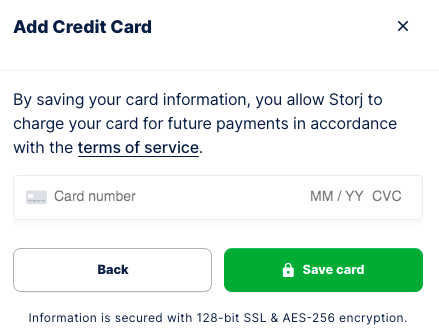

The only thing that worries me slightly is the wording in the popup when I click to upgrade.
“By upgrading your trial will end immediately”
Seems it already has, but I just want to make sure my one project, which is the 85GB backup of these aforementioned photos, is safe and won’t disappear.

True, but for most perhaps not that bad. I’m just one of those who doesn’t want to end up paying much and in proceeding a tiny bit further, I don’t see any options for cancellation. Checked the TOS and the word cancel is not in there.
Seeing “By saving your card information, you allow Storj to charge your card for future payments in accordance with the terms of service.” sounds permanent.

To clarify, upgrading to Pro Account will not result in any files in existing buckets from the free trial to be lost. All your data will be preserved. @jammerdan gave a correct explanation regarding that usage will start getting charged from the time you upgrade if your free trial maximum run time had not expired yet. This would be irrelevant if your account was already frozen.
When you add a payment method, you will regain access to your previously uploaded files and will only be charged for actual usage. So there is no need for using virtual debit cards as a measure to prevent the card to be charged in the future, as you can just delete all your files yourself at any time and thus stop usage charges from accruing, so you will only get a final invoice for the usage up to the time you deleted all your data and then will not have any payments due after that even if you never requested the account to be deleted as described by @Alexey
Your payment method will not get charged in the future unless there was actual usage for storage, egress or segment fees during a billing period. So unless you later upload new files again, no charges will get applied to your payment method.
On the other hand, for customers who are paranoid about getting charged forever which as described above is not a realistic scenario for an unused account with only empty buckets, so they use such measures aa virtual cards that expire or have no funds in them at time of invoicing, they will get their accounts frozen if we cannot charge for usage they did accrue if they just left no longer needed files sit there without deleting them.
Of course any files remaining in an inactive account would result in still generating storage charges, so the customer should delete all those files, buckets and access grants as soon as possible to minimize the amount owed on the final invoice when they decide they no longer want to use our service and want the account to be deleted.
