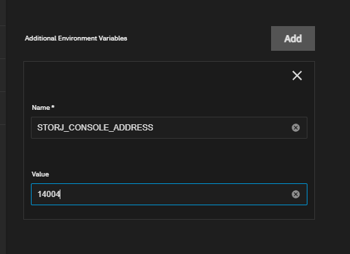

Which is a bit of a problem with using the TrueNAS SCALE app if you want to run on the host network, in order to use tcp fast open, as then it doesn’t give you the option to set the address.
It gives you an option to add a variable, so this is your solution:
If that comment was aimed at my post, I tried setting that variable in the TrueNAS app configuration, but it still tried to open the port at 14002.
Accordingly this it should, maybe a typo?
2025-09-27T18:25:27Z    FATAL   Unrecoverable error     {"Process": "storagenode", "error": "Failed to create storage node peer: listen tcp :14002: bind: address already in use", "errorVerbose": "Failed to create storage node peer: listen tcp :14002: bind: address already in use\n\tmain.cmdRun:86\n\tmain.newRunCmd.func1:33\n\tstorj.io/common/process.cleanup.func1.2:388\n\tstorj.io/common/process.cleanup.func1:406\n\tgithub.com/spf13/cobra.(*Command).execute:985\n\tgithub.com/spf13/cobra.(*Command).ExecuteC:1117\n\tgithub.com/spf13/cobra.(*Command).Execute:1041\n\tstorj.io/common/process.ExecWithCustomOptions:115\n\tmain.main:34\n\truntime.main:283"}
Cheers.
You need to provide not only a port, but also an IP, i.e. 0.0.0.0:14004 or :14004
Both of those options threw the same error of port 14002 in use.
Cheers.
There is no need to use the crappy TrueNAS scale app. Using “Install via YAML” is way better in my opinion.
