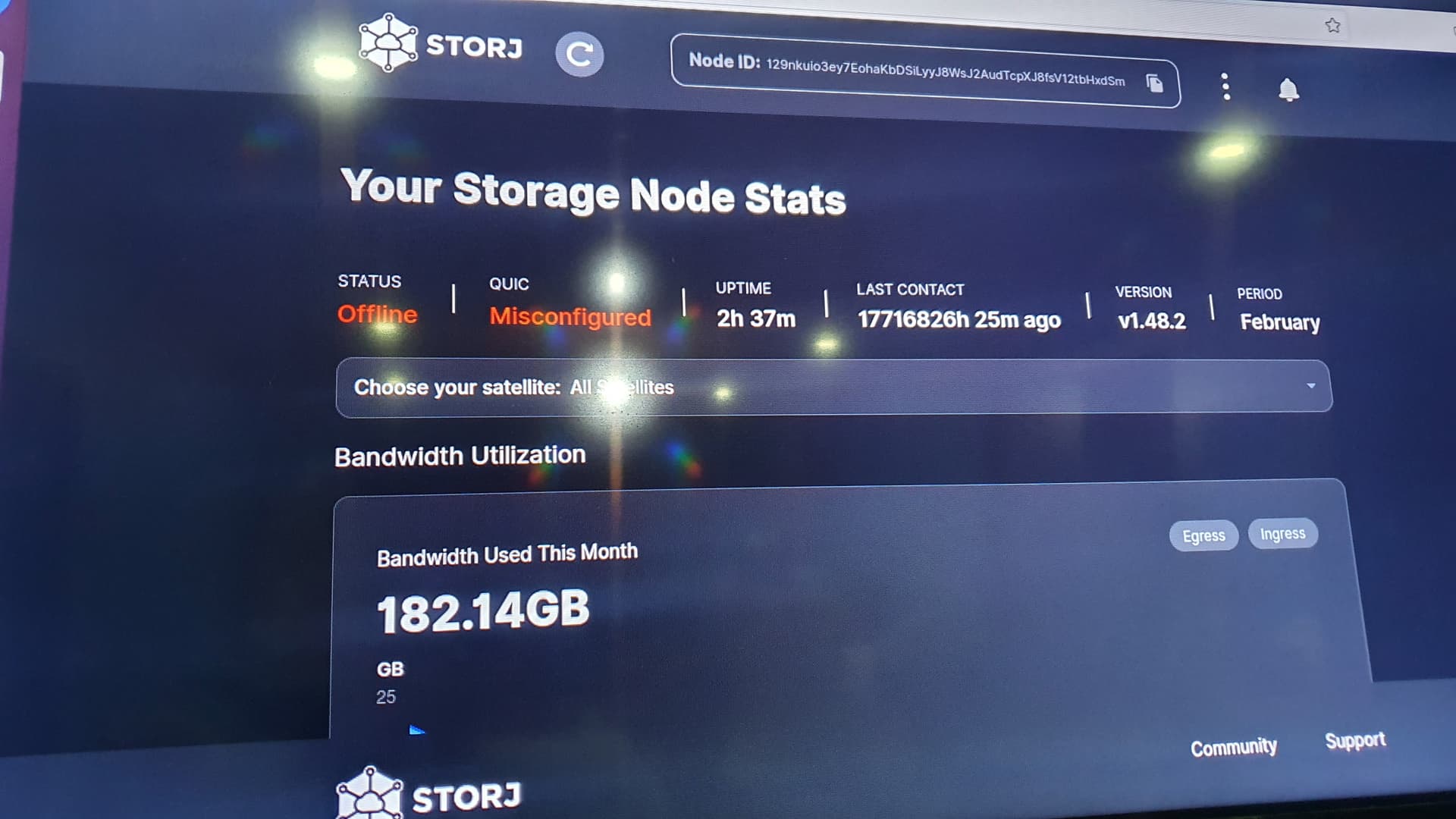

Miss configured node
My node was working fine, then one day it stopped working when i was abroad, i came back home and manually updated the node now i get an error on the dashboard saying miss configured can someone please help me bring my node back up before suspension its been down 4 days
Thank u
Based on the source code there should be a tooltip like:
QUIC is misconfigured. You must forward port … for both TCP and UDP to enable QUIC. See Step 3. Setup Port Forwarding - Storj Docs on how to do this."
Can you please check if you forwarded both TCP and UDP?
‘Offline’ status suggests more of an issue than just UDP port forwarding. Please check the storagenode log file for the latest entries (How do I check my logs? - Node Operator ) and then post them between three backticks
    log text

This error suggests a problem with external access to your node. Please check the public IP, ddns resolution, any firewalls, port forwarding rule(s), and use the open port checker - Open Port Check Tool - Test Port Forwarding on Your Router
thats the thing when i use that tool it tells me the folowing
Success! I can see your service on 186.45.136.181 on port ( 28967 )
Your ISP/Router/Firewall is not blocking port 28967.
DNS host is being updating also yet still i cant access msecaura-access.ddns.net
That IP is not the one being returned for the ddns name…
I got trough i forgot to update my noip host and i didn’t realize the difference in the ips being reported lol thanks alot
