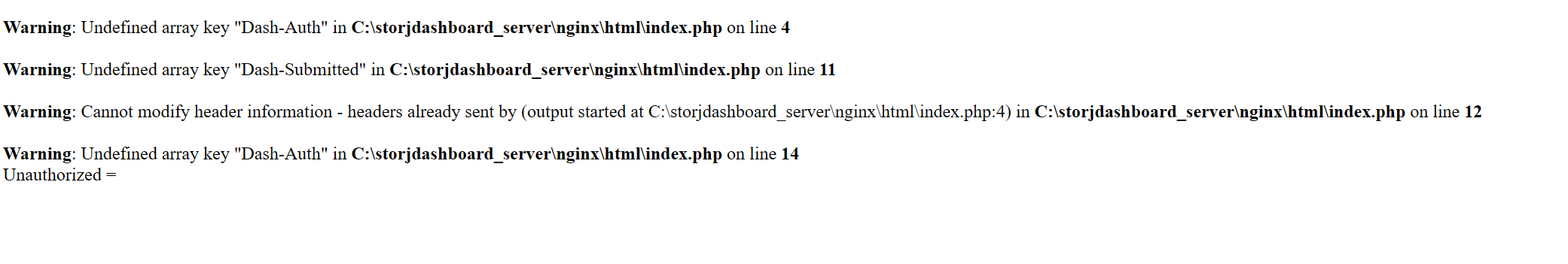

The dashboard does not see my node.
  • TCP port 28000 is open from the outside (TCPfirewall + TCP port forwarding enabled)
  • the access token has been copied to nginx config
  • I tried both “127.0.0.1” and the real node IP in nginx config
Anyelse else that I might `have screwed up?
Hii twl
The auth needs to go into the config.php file within the html folder
<?php $ip="127.0.0.1:14002"; $auth = "abcdefghij"; ?>
so the IP part is the dashboard internally
the Auth part is the bit from the portal
recently added a new bit to the docs might be worth checking out
https://docs.storjdashboard.com/docs-page#portal-create-node
when you visit http://hostname:28000 - are you seeing any page at all ?
Yeah, it looks just like that.
Actually yes, this is what I’m seeing:
Evening all
There is a file update as we have noticed some errors on windows environment with NGINX+PHP - we have updated our GitHub pages
This change is also to support authentication between the checking servers and your NGINX.
If anyone has any questions/issues setting this up please PM or reply here :slight_smile:
