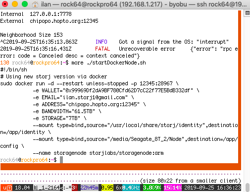

I attached the screenshots of the router settings and the run command.
Thanks for your patience.
The machine that does not get Storj traffic is the Rockpro64.
I am also showing the configuration for a node that does work. It is the Rock64 machine.
23%20PM
The start command screenshot is also attached.
thanks for taking a look.
Ilan
Ok it seems like you’re checking port 28967, which is indeed open, but that’s used by the other node. Port 12345 used by this node is not open, so some firewall must be blocking it. Either on your router/modem in ISP settings or on the node itself. If you have firewalls anywhere allow incoming traffic on 12345. You only need TCP so you can remove the UDP forward if you want, though it won’t hurt your node either. But why have ports open you dont need.
