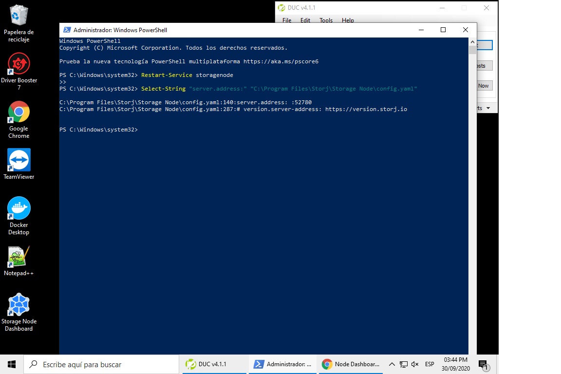

the configuration line is in the config.yaml file in your storagenode folder
you open config.yaml and change the 28967 to 52780
like alexy described…
mine looks like this
# public address to listen on
server.address: :28967
yours need to be the port number you use.

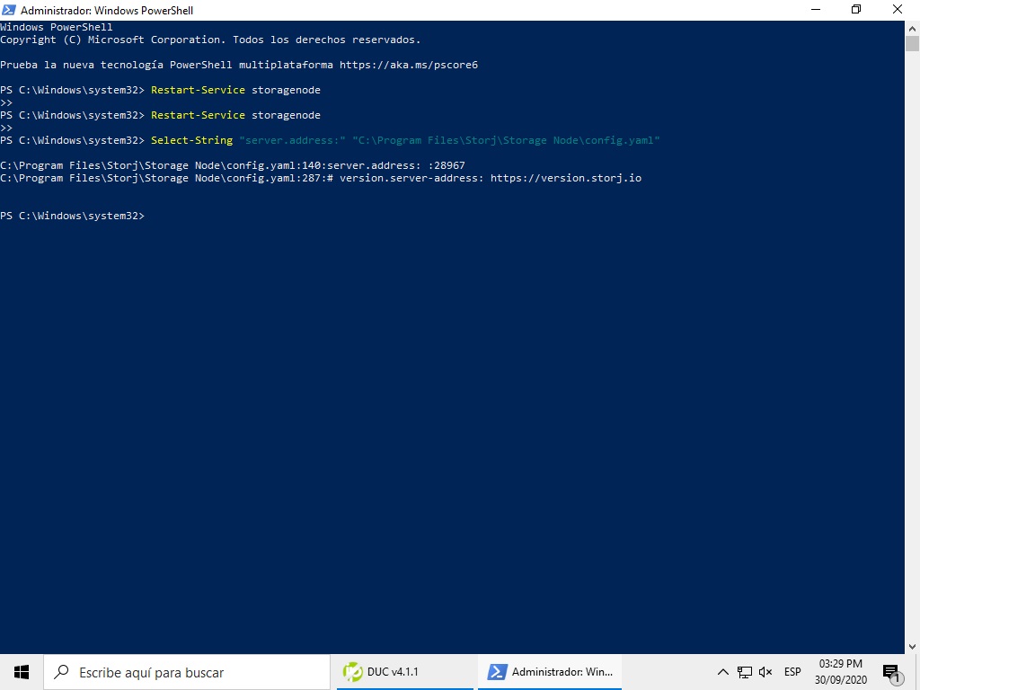

As I thought, you didn’t save the configuration with a new port. I think the external address have not changed too.
Please, save changes in the Notepad++ and restart the storagenode
  1. I executed what you indicated and the following appears on the screen:

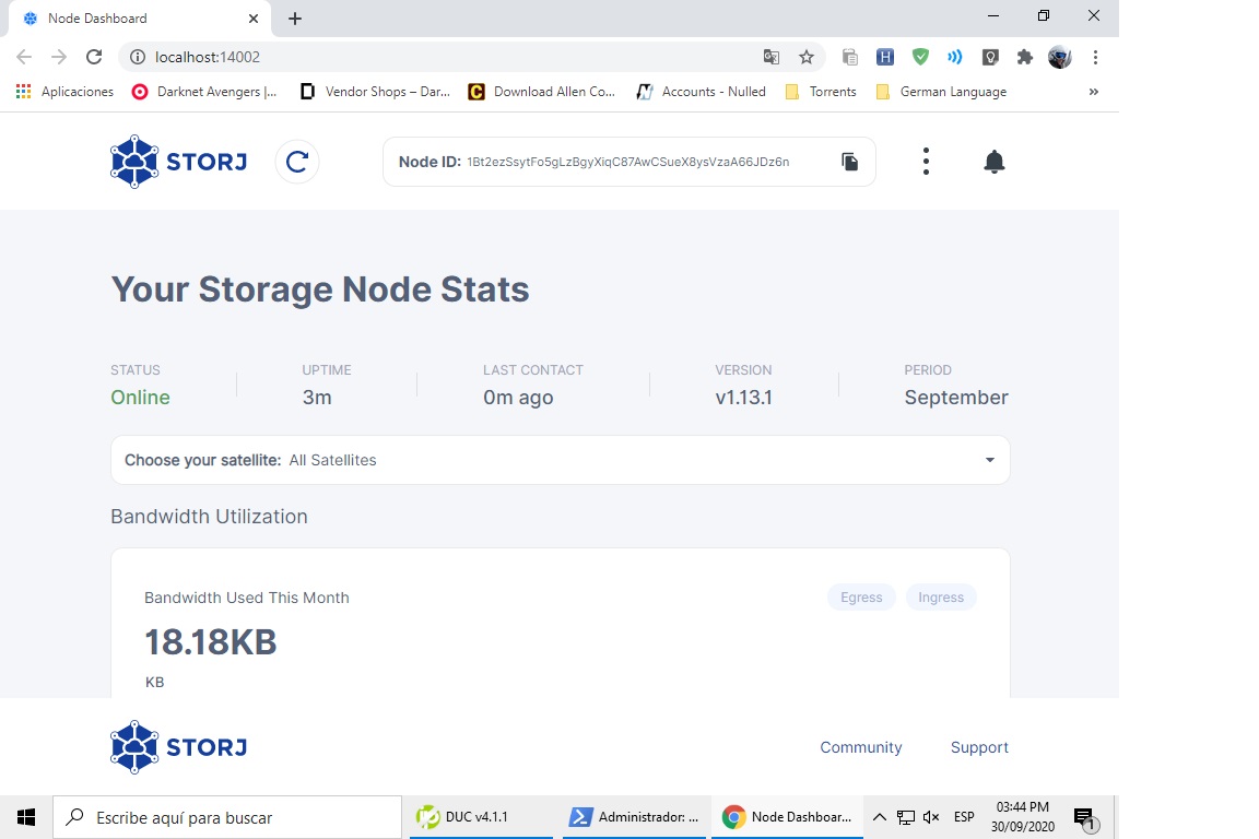

2)I just checked the node’s dashboard and it just appears ONLINE.
congrats …
you can check the logs to see what it’s doing, tho initially it will be slow, but you will get info on stuff like uploaded pieces and if they are successful or not…
but if it says online, then it’s usually fine… but personally i always try to check the logs just for peace of mind… storagenodes do die for various reasons, but if it says online it’s most likely fine.
