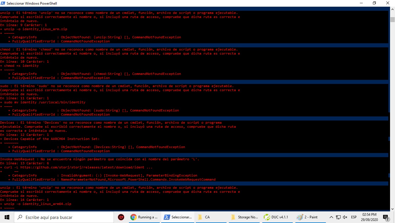

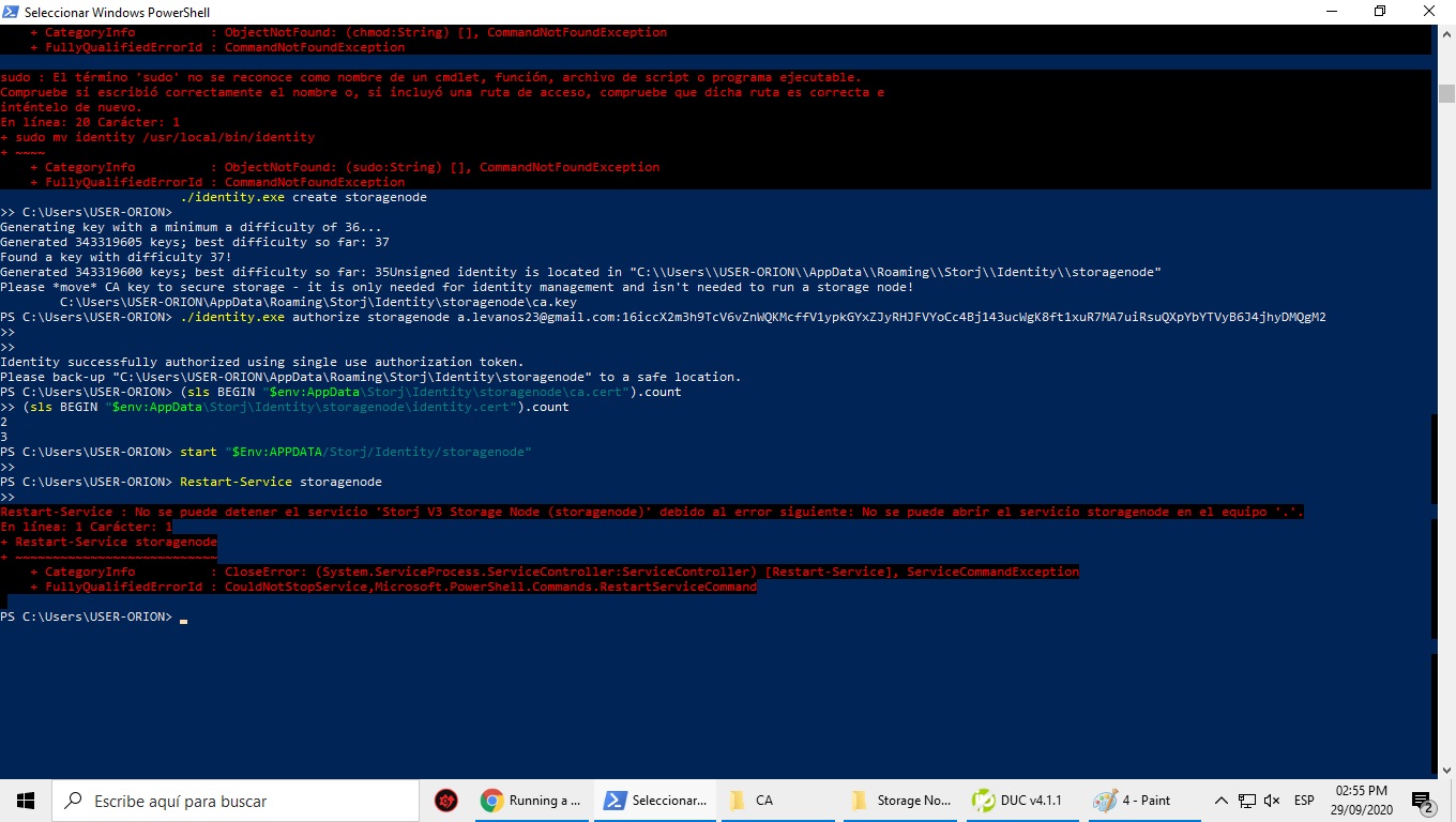

Hi. My name is Richard. A few days ago I tried to create a node in my house but my ISP did not allow me to have a Public IP. Here I leave you the subject of that problem: New node: offline
At the moment, I cannot change ISP so then I formatted the entire hard drive and I started from scratch following the instructions in this guide: Storj / articles / 360026892971-Running-a-V3-Storage-Node-with-PIA-VPN-
However, the node appears to me offline.
I will then start showing the photos of the node installation process in images:
The screen shots are very confusing your running windows and yet running Linux version of the identity?

This may not be your issue, but you have an extra backslash in your log.output entry. Should be:
log.output: winfile:///C:\Program Files\Storj\Storage Node\storagenode.log
Also, you may want to chose another location for the log file since Program Files is typically not user writable unless you change permissions. I would suggest you make a folder on the C:\ drive or use your documents folder.
