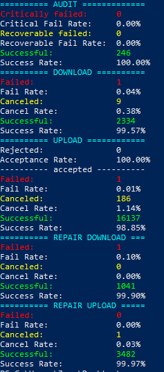

Here is a screenshot from 1 day log,I errased it yesterday:
What do you think?
It looks OK but nevertheless it has some failures.
Don’t worry about those failures unless they pop up for audits. Unfortunately some cancelled transfers still pop up as failures from time to time. Everyone has them and they can’t really be avoided. Audits are never cancelled though so critical failures there are really bad. Others are fine and you success rates look great too. These numbers show nothing to worry about.
Great! Thank you!
