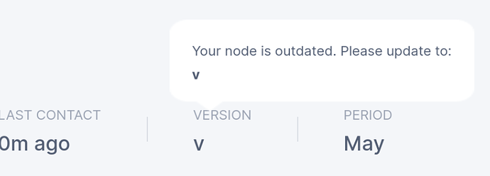

What further troubleshooting is available? I’m seeing the same advice over and over, none of it has helped me.
I’ve run docker stop and docker rm on the container around 15 times today trying to get this set up.
Either your application is broken, or your instructions are incorrect.
I’m on Linux.
Is there any advice that you can provide that isn’t just a repeat of 100 other posts that all say the same thing, which I’ve already tried without any success?

For IP address, I’m providing my actual public IP address. Once I get that working, I’ll switch to a service like noip or duckdns. I just want to see this work once, with as simple a config as possible.
This is not needed. Your node seems doesn’t work (perhaps restarting), thus your web-dashboard doesn’t show real values. It also possible that your browser blocking some content (rare case), js for example.
Please provide the last 20 lines from your logs: How do I check my logs? | Storj Docs

storagenode does not work and throws exceptions. In this case 20 lines is not enough to show a full stack-trace.
Please try to provide an excerpt from logs since node start. You can use this service to upload archive with log file: https://transfer.sh/, you can replace a private information with placeholders.
Pointing me at logs was a huge help, thank you!
I’ve solved the problem- it was a small myriad of things due to restarting the process and having leftover config.yaml files with conflicting information, then also not enough space (I had unmounted my external storage while troubleshooting), etc.
If I had been reading those logs from the start, I would have saved myself a decent amount of trouble. They made all the difference.
I think the panic it experienced at the end was simply an anomaly.
I’m up and running now, thank you for your troubleshooting advice! Whew!
