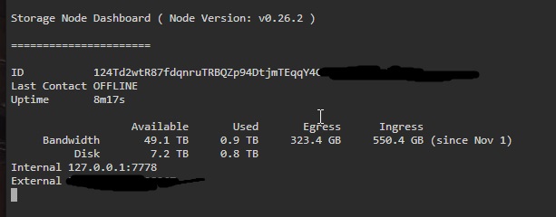

check your disk is mounted, it tels than it sens disk space is lower than you writen in config
What Hdd connection do you use?
If you mean the physical connection it is sata
is it mound permanently on fstab?
Did you checked firewall?
i don’t think it is a drive error the only thing i updated was the ip
I didn’t change anything in Rauter
did you updated external ip?
…yes in the docker.

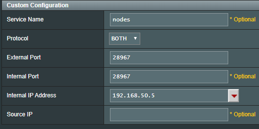

Try to check your ports are opened https://www.yougetsignal.com/tools/open-ports/
node local ip ben also changed?
no.
it is a docker on unraid system
do i need to put the internal ip in the router port forwarding or the external?
Yes you should forward port on router to node pc with 28967 port.
do i need to put the internal or the external ip in the router port forwarding ?
external to internal
steel doesn’t work
