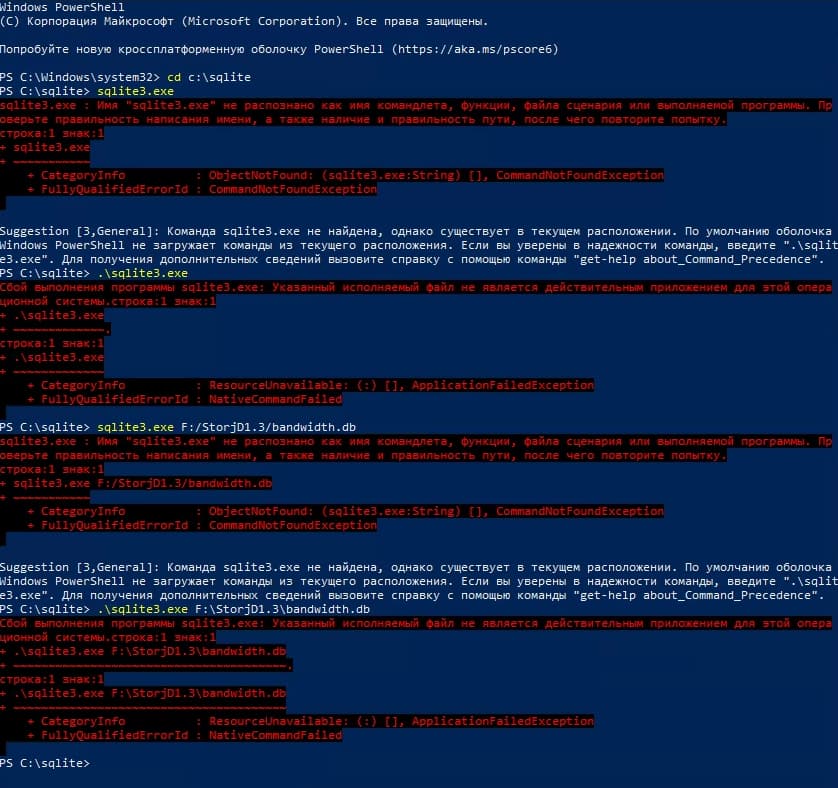

Hi,
I stack with this:
Or in PowerShell:
Could you, please, help!
If you want to use a native sqlite3.exe, make sure that you downloaded a correct version for your Windows (if you have a 64 bit Windows, make sure to download from SQLite Download Page).
And as far as I know, they distribute this utility as an archive. Did you unpack it?
In cmd.exe you need to run it without leading ./ or .\. In the PowerShell you need to use ./ or .\ before the command (if you are trying to run it in the location, where you unpacked a binary).
Thanks Alexey. Version was correct. I have uploaded new sqlite files instead of previous and it become work.

You need to perform commands outside of the sqlite3.exe session, in your PowerShell.
The sqlite3.exe binary is used to manipulate databases, not files.
I thought instruction is clear, but seems not.
  1. Exit form the empty sqlite3.exe session (you usually should not open it without any arguments):
.exit
  1. In the PowerShell session:
cp F:\StorjD1.3\bandwidth.db F:\StorjD1.3\bandwidth.db.bak
  1. Now run sqlite3.exe with the path to the database, it will open an sqlite3 session
sqlite3.exe F:\StorjD1.3\bandwidth.db
  1. Unload all not corrupted data from the opened database to the file (from the sqlite3 session):
.mode insert
.output F:\StorjD1.3\dump_all.sql
.dump
.exit
  1. Now in your PowerShell prepare data for load
Get-Content F:\StorjD1.3\dump_all.sql | Select-String -NotMatch TRANSACTION | Select-String -NotMatch ROLLBACK | Select-String -NotMatch COMMIT | Set-Content -Encoding utf8 F:\StorjD1.3\dump_all_notrans.sql
  1. In the PowerShell remove the corrupted database:
rm F:\StorjD1.3\bandwidth.db
  1. Create a new bandwidth.db database with sqlite3 from the PowerShell and load prepared data:
sqlite3.exe F:\StorjD1.3\bandwidth.db ".read F:\StorjD1.3\dump_all_notrans.sql"
  1. Check, that size of the database is not zero (PowerShell):
ls F:\StorjD1.3\bandwidth.db
if size is not zero, you may try to run your node back from the elevated (as an Administrator) PowerShell:
Start-Service storagenode
Then check your logs, if node is running - check your dashboard.
If the database has zero size, then you need to re-create it:

the restored database has 0 size as a backup one. That’s because you specified a wrong path to it.
Your databases not in F:\Storj4.3 as you specified, but in F:\Storj4.3\storage,
so
  1. Backup
cp F:\Storj4.3\storage\bandwidth.db F:\Storj4.3\storage\bandwidth.db.bak
  1. Open database
c:\sqlite\sqlite3.exe F:\Storj4.3\storage\bandwidth.db
  1. Unload data
.mode insert
.output F:\Storj4.3\dump_all.sql
.dump
.exit
  1. Modify data for load
Get-Content F:\Storj4.3\dump_all.sql | Select-String -NotMatch TRANSACTION | Select-String -NotMatch ROLLBACK | Select-String -NotMatch COMMIT | Set-Content -Encoding utf8 F:\Storj4.3\dump_all_notrans.sql
  1. remove the corrupted database
rm F:\Storj4.3\storage\bandwidth.db
  1. Create a new one and load data
c:\sqlite\sqlite3.exe F:\Storj4.3\storage\bandwidth.db ".read F:\Storj4.3\dump_all_notrans.sql"
  1. check size of the resulted database
ls F:\Storj4.3\storage\bandwidth.db
