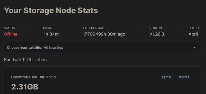

Online starage yet offline nodes?
once i find out why. i will reboot it. i have fiber around 600down 300up 7ping. so i know it’s not the internet. it may be the config file. idk exactly how to configure it. if i can i don’t want to use docker although it’s running on my pc not begin used. i’ve been trying to figure this out for 2weeks. all i can say is help if possible. please and thank you in advanced.

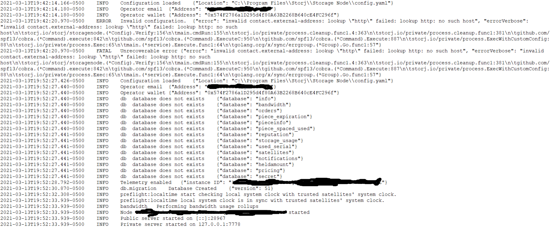

@IncredibleGeek What do your logfiles say? They should be able to narrow the issue down.
the rest gets very redundant. with a message here and there. 2021-03-13T20:52:33.941-0500 INFO bandwidth Performing bandwidth usage rollups. and the redundant message is about failing to ping a satellite. the entire file is 18MB long. and i tried to post what i thought was important. idk how to link the whole thing as an attachment. unless i put it in a paste bin of some sorts.

Seems you specified address of your node with http:// included, you should remove it and any remained slashes. It should contain only hostname and port via colon in your config.yaml file (see Where can I find the config.yaml? - Node Operator), i.e.
# the public address of the node, useful for nodes behind NAT
contact.external-address: "my.ddns.tld:28967"
Please, use a Notepad++ text editor to modify the config file. Explicitly save it (menu File - Save) and restart the storagenode service either from the Services applet or elevated PowerShell:
Restart-Service storagenode

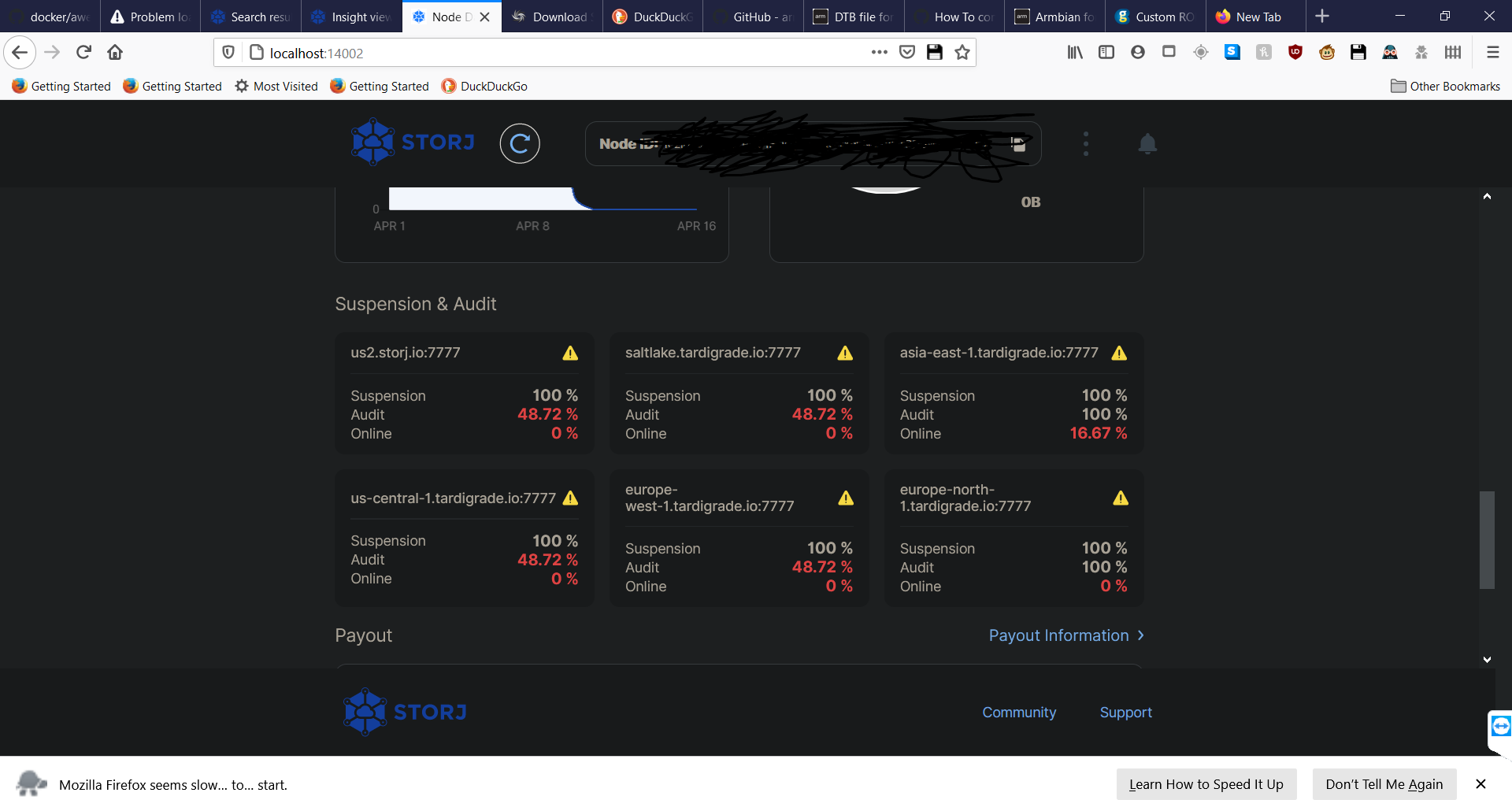

I can see that audit scores for almost all satellites on your node are below the 60%, so your node is disqualified already. I can assume that you lost files.
If this node is new, maybe it’s better to start from scratch: delete the current identity and data, generate a new identity, sign it with a new authorization token and start with clean storage.

also what’s odd to me is 48.72% on 4 of them. 1 understandable. 2 coincidence. but 4. that’s a pattern. i was wondering if i could find out why that number and how to prevent it. also that online 0% was like that from the start. even when status was online. the bottom right one is how they all looked 24/7. idk if that’s normal.
i did create a new identity and will restart once i have some form of confidence that 48% won’t happen again. also want to know why 0% all the time. if possible. thank you.

Did you check if your dyndns-service has the correct ip?
I had this once, because i swapped my router, dyndns was not updated, the nodes where online, but showed as offline, because they were not reached from outside.
P.S.
If your hostname and port from the screenshot are the actual hostname and port:
i just tried to reach your storagenode via telnet, its not working.
While i can reach my own via telnet no problem.

ok status is offline tho. so how are you able to connect? yet drives are online… i am soo confused.

Please, use this command to check what is actually saved on the disk:
sls "contact.external-address:" "C:\Program Files\Storj\Storage Node\config.yaml"
If it returns something different from what you typed - you likely did not save the config. Notepad++ can be closed with modified file, it will not ask you to save it. When you open editor again, it will open modified file (but not actually saved). Thus you need to click menu File - Save, confirm administrator’s rights and click on menu File - Save again. After that you need to restart your node.

Please, check your logs: How do I check my logs? - Node Operator maybe it’s stopped with some error.
