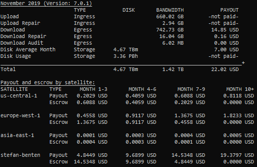

I figured I’d offer some more feedback on this months payouts. It seems satellites have consistently paid out more than I was expecting.
us-central-1 ($0.8118; 75%:$0.6088; surgex4: $2.4352)
Received: 34.83595734 ($4.01)
europe-west-1 ($1.8233; 50%:$0.9117; surgex4: $3.6468)
Received: 59.54780419 ($7.16)
asia-east-1 ($0.0005; 50%:$0.0003; surgex4: $0.0012)
Received: 0.01197882 ($0.00)
stefan-benten ($19.3797; 75%:$14.5348; surgex4: $58.1392)
Received: 545.69426414 ($65.59)
Etherscan can now show estimated value at time of transaction. That’s what I used for the dollar values for the payouts. Obviously not complaining about getting more, just providing feedback.
I haven’t been keeping track of who’s node is in which month but… The payout seems to make sense if your node is in the 7-9 month escrow period considering the 4x surge payment.
Are we still talking about 12aYrWFmJqrmhN3zgkvANBTsj2DdLwf2aZC8T5t7CrNazHahKXW ? US-Central is telling me that this node joined 2019-02-28. I have double checked this edge case last month because my node joined on 2019-01-31. If you join on the last day of a month we count this month for the hold back calculation even if you didn’t manage to get any data. We are fine with this edge case.
Congratualtions in terms of the hold back calculation you are in month 10 with 0% hold back. That should explain the difference in payout.
And one other detail.
Depending on the date you joined you still get 5x surge pricing. My understanding was that 4x level and lower are for the nodes that would join now. Should I double check it or should we just take the money and not question it :slight_smile:
Haha, might wanna double check that. I mean I won’t say no to the money, but I’m mostly trying to understand where the numbers came from. It was indeed still about node ID 12aYrWFmJqrmhN3zgkvANBTsj2DdLwf2aZC8T5t7CrNazHahKXW. Correcting for the additional month I actually get numbers that are in some cases further away from what I got before. Assuming this applies for both us-central-1 and stefan-benten which were active at the time.
us-central-1 ($0.8118; surgex4: $3.2472) => got closer
europe-west-1 ($1.8233; 50%:$0.9117; surgex4: $3.6468) => no change
asia-east-1 ($0.0005; 50%:$0.0003; surgex4: $0.0012) => no change
stefan-benten ($19.3797; surgex4: $77.5188) => got further away
For europe-west-1 and asia-east-1 I assumed the first month I got payout from those were the start of the 9 escrow months, though I guess it’s possible my node connected with them in prior months as well, despite not receiving data.
Playing around with the numbers a bit, I think this may be the most likely scenario. Assuming you are correct and x5 surge is still in effect. This would suggest only us-central-1 actually counts February as the first month. And europe-west-1 is actually already in 75% payout for some reason. But no matter what numbers I choose for stefan-benten, the amount seems a bit off.
us-central-1 ($0.8118; surgex5: $4.0590)
europe-west-1 ($1.8233; 75%:$0.9117; surgex5: $6.8373)
asia-east-1 ($0.0005; 50%:$0.0003; surgex5: $0.0015)
stefan-benten ($19.3797; 75%:$14.5348; surgex5: $72.674‬)
You don’t have to do further checks for my benefit, just providing the info in case you want to double check things on your end. I’m happy either way. :slight_smile:
Please double-check.
Am I understanding you right, that my node is in the same month for each satellite, even though the node didn’t have contact to all satellites in month 1?
Yes that is correct. The other satellites joined the network later. They have different start dates for all storage nodes. If needed I can get the earliest date per satellite.
Needed is a strong word, but it would be appreciated. :slight_smile: I appreciate the detailed responses a lot already!
US-Central: 2019-01-31
Stefan: 2019-03-03
EU-West: 2019-05-31
Asia-East: 2019-06-10
Thanks! That exactly confirms the numbers I found playing around. Looks like the surge payout is indeed still x5 for existing users. Only difference that remains is that the stefan-benten payout is roughly 10% below expected. Last month I saw a similar but slightly smaller difference.
