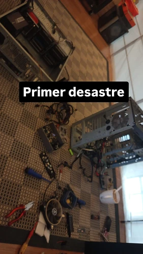

Upgrading my setup
4 full tower with 10HDD each tower
Going into an open frame rack and 12HDD server case
First server almost done
