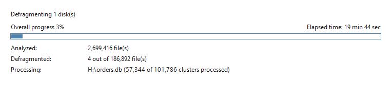

I’ve also stopped the node right now and started defragmentation. The orders.db file has over 13k fragments scatted on the whole disk - it’s madness. And 2 MB files have over 500 fragments. No wonder it’s working slow.

This looks pretty bad…
I would disable defraging on that drive you will end up killing it.
It’s probably better to put some strain for an hour or two to sort things out than to tire disk more in the long run.
