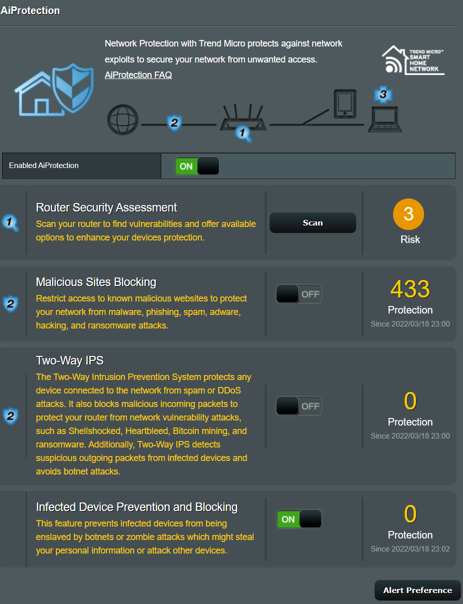

Well I was not able to find DOS setting on my router. But on forum I have found that maybe this is it:

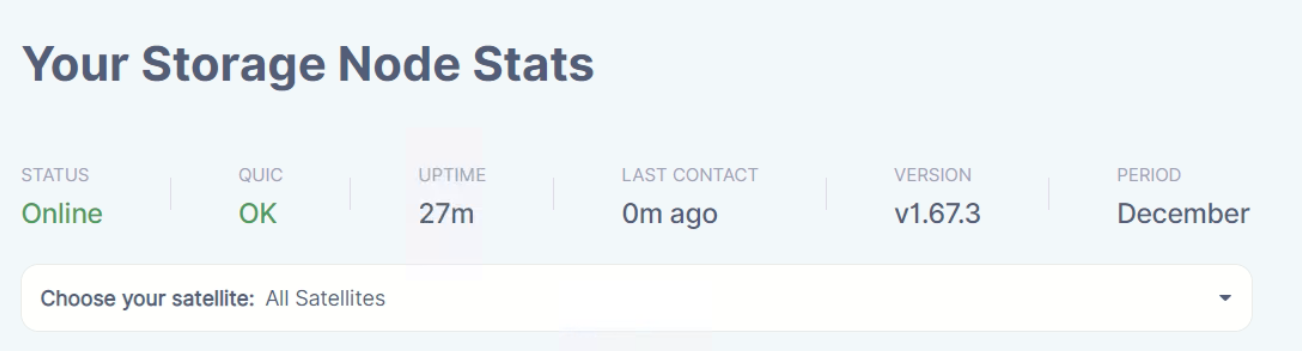

I have disabled it and recreated first node on my DSM and Docker and whoa :open_mouth:
Can believe it that this was the issue (maybe not) because this started by DSM update and did not go away after router change and tried lot of settings. I have tried even remove all NAT port FW rules and keep running only one node on DSM and one rule on router (still issue).
Finally I have Two Greens!!! :star_struck:
Thank you everyone for help and cooperation. Much appreciate :slight_smile:
Wigo
@LordWigo
I forgot to tell you to disable all the malware protections in your router. My Asus addons from TrendMicro interfers with the SN too. Please disable the first option too.

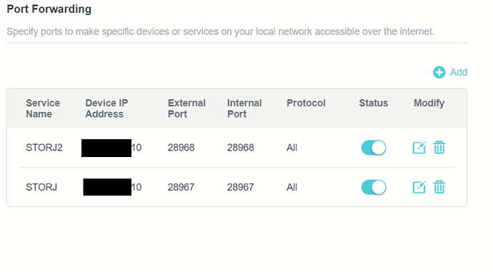

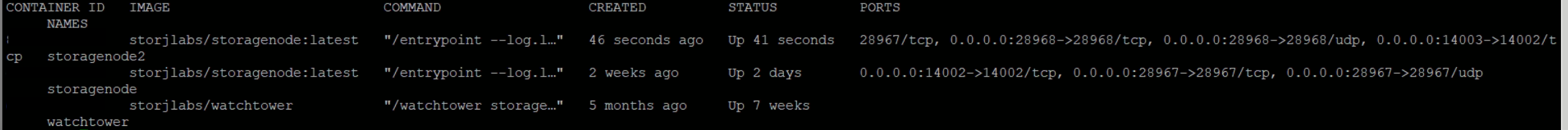

Yep, I am right. Using 28967 for both nodes on the same machine in Docker, Synology NAS, dosen’t work for me. I tried. I don’t know why dosen’t work like you all said, both nodes seem to listen by design to 28967 TCP, but they can’t use it both in the same time. I refreshed browser, close it and restarted it (it deletes everything on close); it’s not a visual error. Here are the steps… I use putty and sudo su before docker run.
Variant 1:
  1. router port forward: 28967 > 28967 TCP and UDP, 28968 > 28968 TCP and UDP.
  2. docker run ports: node1 - 28967:28967 TCP and UDP, node2 - 28968:28967 TCP and UDP.
  3. node2 OFFLINE and QUICK misconfig.
docker run -d --restart unless-stopped --stop-timeout 300 \
	-p 28968:28967/tcp \
	-p 28968:28967/udp \
	-p 14003:14002 \
	-e WALLET="xxxxx" \
	-e EMAIL="xxxxx" \
	-e ADDRESS="wan-ip:28968" \
	-e STORAGE="7TB" \
	--mount type=bind,source="/volume2/Storj2/Identity/storagenode/",destination=/app/identity \
	--mount type=bind,source="/volume2/Storj2/",destination=/app/config \
	--name storagenode2 storjlabs/storagenode:latest \
	--log.level=error
Router:
Node1:
Node2:

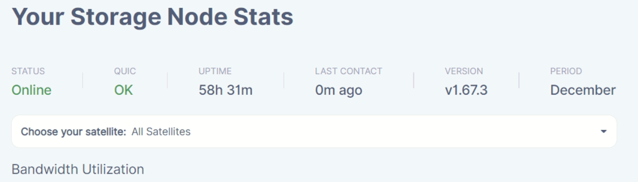

Variant 3:
  2. docker run ports: node1 - 28967:28967 TCP and UDP, node2 - 28968:28968 TCP and UDP.
  3. node2 ONLINE and QUICK OK.

Looks like you changed the server.address: option on the second node to listen the 28968 port.
Usually this is not needed for the docker nodes.
So should I use 28967:28967 everywhere, for both nodes? Includind server address wan-ip:28967?
Since you already have node listening 28967 externally and you want to run the second node on the same device, for your second node you can use these settings: router 28968->28968, docker 28968:28967/tcp and 28968:28967/udp, dashboard 14003:14002, ADDRESS=external.tld:28968.
Your current variant will work too, if you want to map 28968 to 28968 for the second node instead of 28968:28967, then you need to change the default option server.address: :28967 to server.address: :28968, so the mapping 28968:28968/tcp, 28968:28968:/udp will work too.
