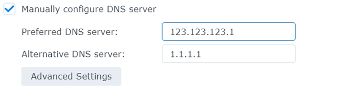

You should have something like this on the LAN1 where your router is connected for the storagenodes:
Forward ports in router to 123.123.123.2, in my exemple.
