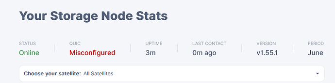

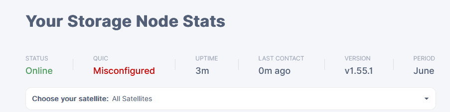

Only one container and one simple rule does not work either:

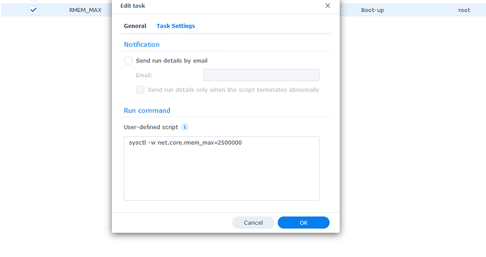

I have tried increase this value but also did not help:
xxxxxxxxx@SYNOLOGY:/$ sysctl net.core.rmem_max
net.core.rmem_max = 2500000

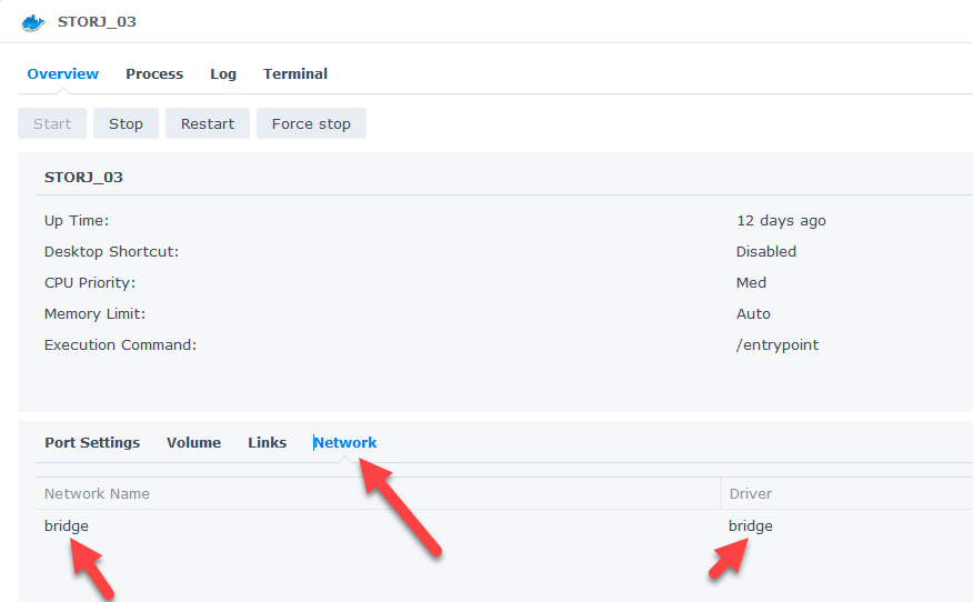

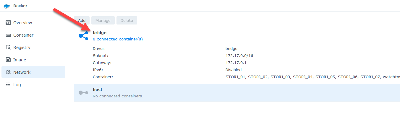

Docker network looks like:
As you can see I am in Bridge mode. As I mentioned in thread this worked without issue before DSM update. Router does not filter based on MAC. I have opened ports based on IP address…all docker containers are behind the same IP just changed port for each both TCP and UDP and all are online so from point of router looks all good.
This is how container is configured:
