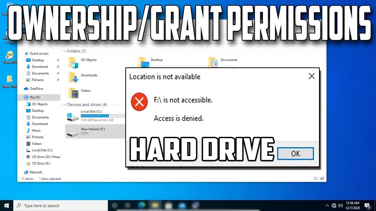

In Docker Desktop, I have a problem with disk sharing. I can share one from D:, which works, but the second one doesn’t work when sharing from E:, but I have to share the two folders, data and identity, and this seems to be causing problems.
You can fix that - you need to change the owner of the disk and data to your user recursively, which you use to run Docker Desktop, then you should be able to share it.
How? And why only on one disc???
Maybe it was on another Windows before, who knows.
