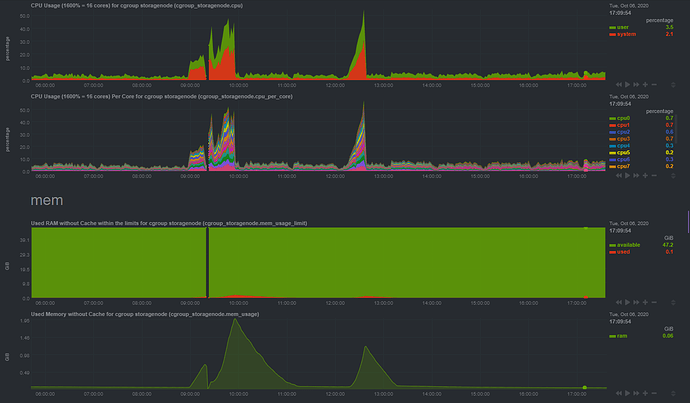

well my storagenode sure uses its extra ram for something…
i duno why it does this… but it happens, not sure if it needs the extra ram either…
i am migrating the node away from this pool, and there does seem to be a bit of an added activity spike at that point… might have been when i updated to version 1.13.3 actually…
yeah this was triggered by me booting the node after the update, which made it run the filewalker and do trash collection… which apparently used that… these functions usually takes about 80 minutes
from a cold start and might become slower with less ram…
