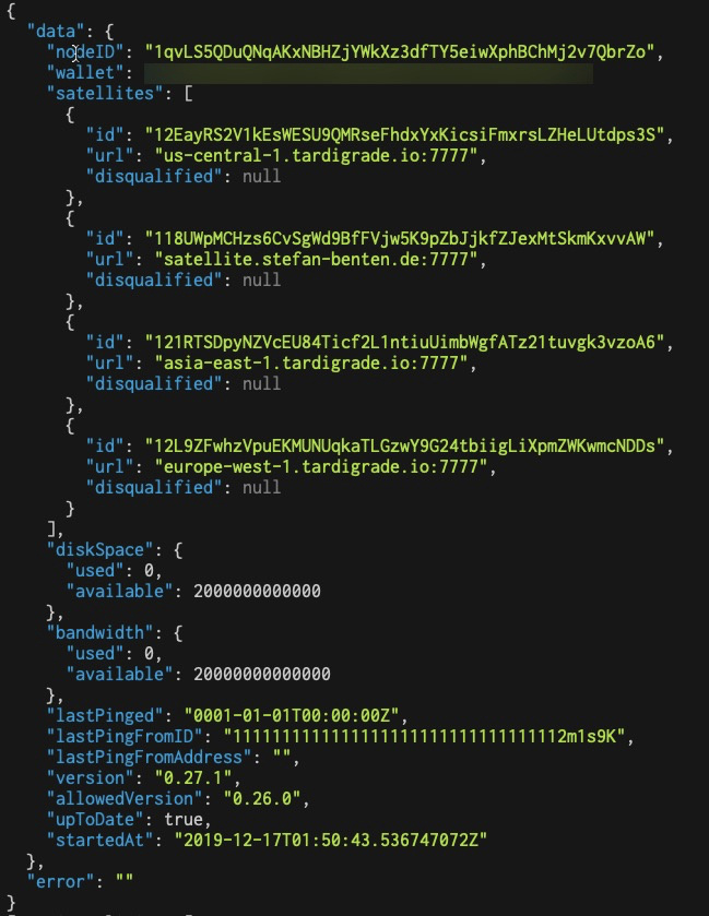

Here is a call to the dashboard API:

Oh yes, everything works, just the node is OFFLINE. But i can see the dashboard, query the API, etc
