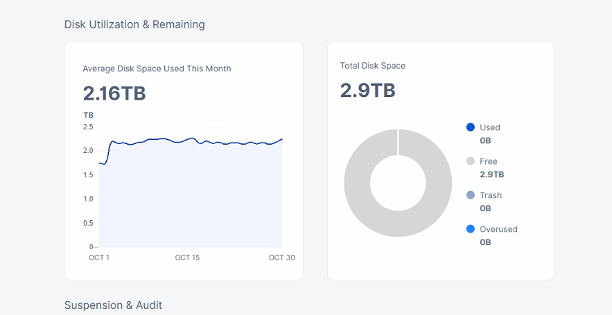

Single node and multinode dashboards shows different values after migration to hashstore

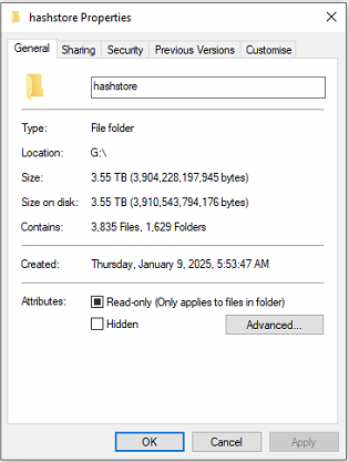

Based on your screenshot, OS reports 3 940 322 660 352 used bytes (and 4 000 768 323 584 capacity).
Which means you have 98920424746 (98 GB) used space which doesn’t belong to any hashstore logs or hashstore table (old piecestore files? temp files?)

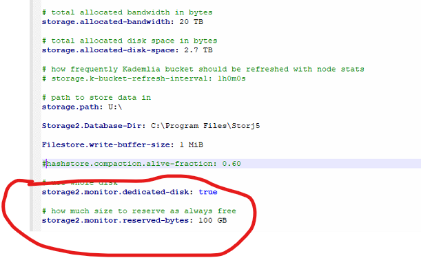

I don’t know what is your configured allocated settings, but I assume you set a high number (like 4TB). When the disk is smaller, that will be used.
In case of dedicated disk the reserved bytes are also deducted.
Which means that you have 3.7 TB available (300GB is the default reserved bytes for dedicated disk space measurement).
This explains why you didn’t receive any new data. It simply reserves some bytes.
Couldn’t see any bug in the calculation here, just unexpected reserved bytes.

  1. In case of using a storage2.monitor.reserved.bytes=100GB, I would recommend to use hashstore.compaction.rewrite-multiple: 5 (The highest hasthable size is 16GB, 16 * 6 = 96GB. Which means rewriting table + 5 log files should be less than 100GB)

Trash folder is 0b, temp files 0, blobs files 0.
So this 98 gb is used by hashstore.
limit is 3.6TB so it havely overused, but it takes data in.
I can confirm that this is a bug. But this is UI only.
The dedicated disk space monitor don’t calculate the UsedForPieces field which is used by the UI. (because it doesn’t know anything about pieces, it just calculates free space quickly).
Fortunately it shouldn’t affect the behavior of storagenode. The counter which reports the free space to satellite is based on TotalSpace which is calculated well.
That’s why the dedicated called experimental, not all the use-cases tested yet, just the one what we use…
We use it for all select nodes (with default 300GB reserved bytes). We don’t have UI on select storagnodes (disabled, as we also disabled bandwidth monitoring). We monitoring everything with Prometheus (in fact: Victoria Logs) and Grafana.
That’s why we didn’t notice this, yet.
But should be fixed. Thanks for the report.
is it alocated space in config in windows GB or decimal GB
Decimal if you use 100 GB, 1024 based (IEC) if you use 100 GiB
So with 4TB HDD, even 3.9TB in config should be fine, as it will leave about 90GiB free, but it eat it out till 0 is free
if we account that compaction need 100GB as temp buffer. So 3.8TB should be fine also?
What is the minimum amount should be to be safe?
