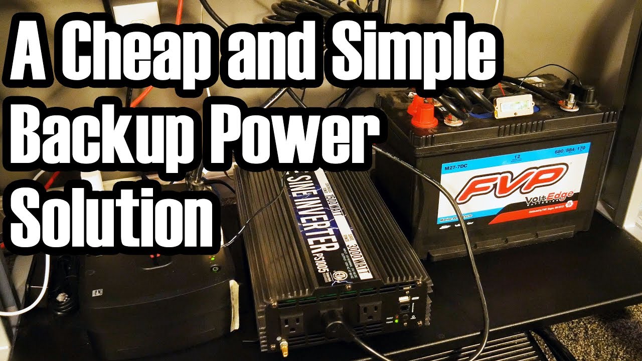

Electrical supply, i know my supply is highly stable to the point where my only considerations are getting some mains filters and fuses to ensure against overvoltage and the likes.
stable power is critical for reliable operation of most electronics.
Another thing i have considered is a small UPS type solution for safe shutdowns of the server in case of power outtages, but since i’m using a Copy on Write filesystem, i should see minimal effect from power losses and so there ill leave that to be better explain by those actually requiring and or utilizing those power stabilization technologies.
And don’t forget grounding, i never really grounded my consumer grade computers and never really had much issue with that, but it can be a critical point of trouble which will rear its head in the weirdest of ways, especially when dealing with long copper based network cables, multiple power supplies and various devices hooked up right and left, at best it’s errors, at worst something will give up the magical blue pixie smoke… alas moving on
Power supplies, i’ve dealt with a lot of bad power supplies, ranging from the cheap which would act up at any sign of electrical noise… i’m also told that a large portion of harddrives often fail due to bad power supplies, your power supply or PSU is the last line of defense for your computer, it is the component that keeps everything alive and running smoothly, having a problem here or being cheap rarely pays off in the long run, some servers do have multiple PSU’s because they can wear out, especially if they are overloaded, loading any PSU beyond 75% of it’s capacity shouldn’t be recommended, it’s rarely worth it… tho i have had expensive power supplies that just wouldn’t die…
running at 125% of rated wattage, burning them to nearly a crisp, running with broken fans and what not… it’s quite impressive what well designed gear can take.
Many HA servers will have dual PSU’s allowing for zero DT hotswap, which is nice, but also you will have a second PSU increasing the expense of gear and wattage consumed, i’m not aware how bad the added wattage use actually is, but i’m confident that it’s not zero… but if i was to hazard a guess maybe 25-50watts extra power draw for a dual PSU solution, and if you got a quality PSU running at 60% or 50% capacity, then PSU failure seems to be very rare cases in my experience.

@stuberman also on the topic of surge protection, then it might help… but then again… if you have quality hardware and haven’t had issues… might be less of an issue… ofc as the price of the setup keeps going up… minor stuff like that becomes a worthwhile insurance…
ended up watching this one the other day…
he does some very interesting videos on random tech one doesn’t really think about… which i kinda like.
this is a neat little setup, even if very ghetto
also learned recently that the red button glowing on off button on extension cords, actually show if the surge protection circuit is bad… it will start to flicker… and one has to replace surge protection circuits ever few years because they will wear out … ofc power conditioners are an options… but really then i rather just put money into solar and like his ghetto setup use a charge controller to charge the battery bank which an inverter uses to power the system with…
that would essentially do away with almost all possible issues… i would almost say it could survive a lightning strike… but few things can… and rarely stuff with wires… so imo surge protection is okay… but don’t count on it always protecting you… but i suppose 10% odds are better than 100% odds of failure for the same event
I enjoyed his video until I got to the end where he showed that he also had a UPS running… why didn’t he just add the big battery to the UPS to provide extended up time? He really did not need to buy a $300 inverter and a trickle charge when the UPS does both.
